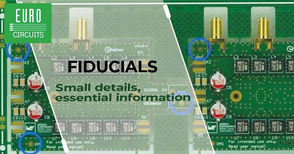

They are used for alignment by pick-and-place machines.

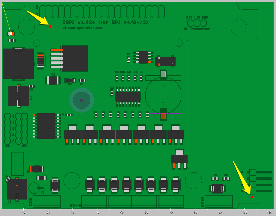

There’s global vs local. Global fiducials are usually placed very widely apart nearer the board outline and use at least (3) as 3 points define a plane geometrically. Local fiducials are usually placed very close to very fine pitched devices (~0.4mm and below). Sometimes assemblers can use footprint features to act as a local fiducial (like corner pads on a BGA) but it depends on the capabilities of the machine vision equipment used.
I usually always use global fiducials, but rarely use local fiducials as I generally don’t use many <0.4mm pitch devices.
