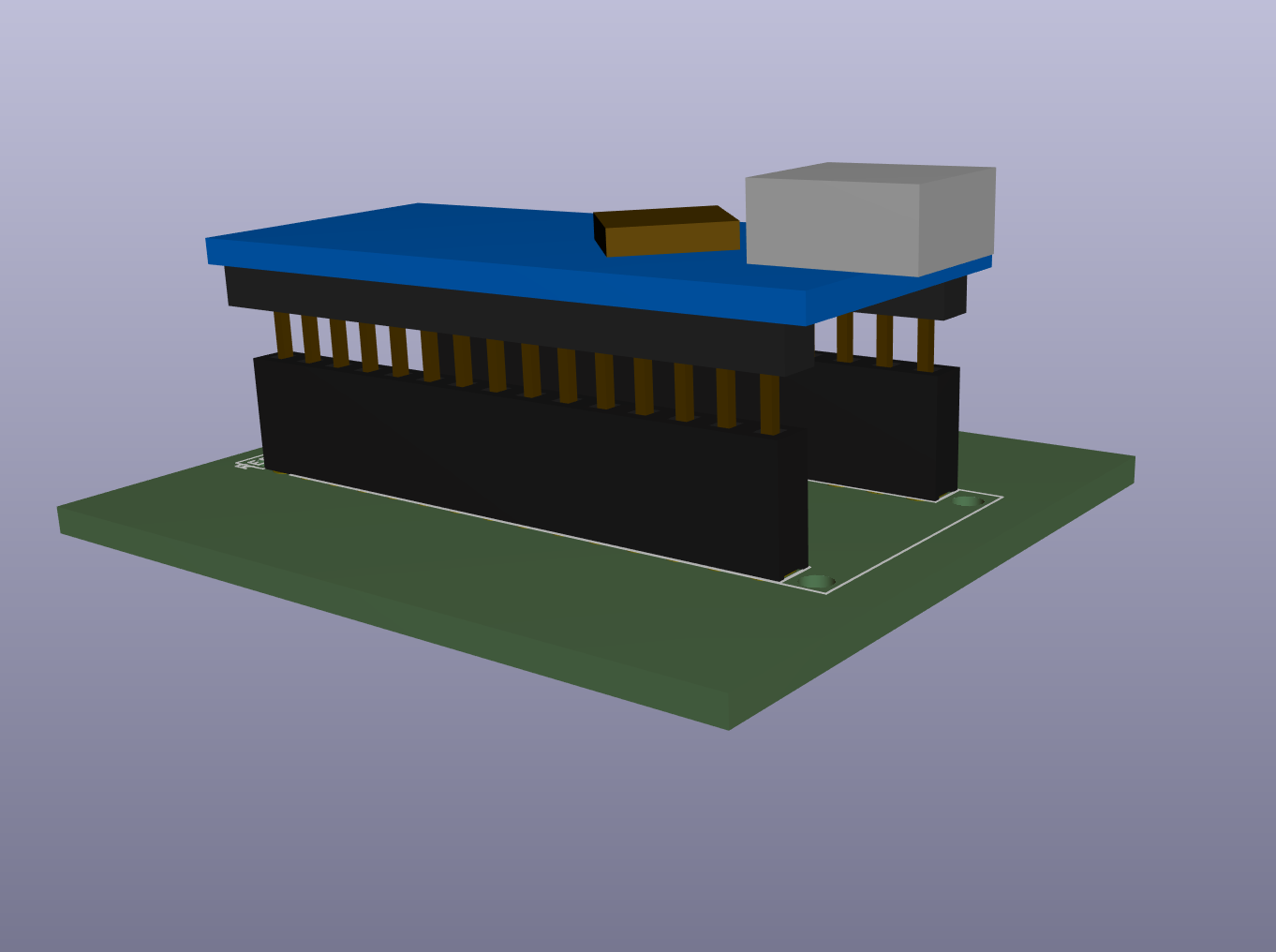

It wasn’t clear on just what you really want to do. I think you’re wanting to have sockets on a PCB to plug the Nano into.
If that’s correct - you’ll want Two parts called PinSocket and placed at pitch of 15.24.
Then, a Nano can plug into it.
Example below with a large gap to see what’s going on… Of course, you’ll need to learn to adjust the 3D footprint of the Nano to get it looking like what I show. But, that’s only for graphics as the Nano isn’t really part of the PCB (if just wanting something (sockets) to plug into).

An Uno will already have pin sockets so you would need to mount pin headers on your board and to have enough clearance, remember the Uno extends beyond the pin sockets, and don’t forget the USB/power cable. The Nano or clone may or may not have pin headers soldered on when sold. You might want to have a sample in your hand and see the 3D clearances rather than relying on photos.
Some time ago I designed a board that plugs on top of arduino Mega256, and holds an arduino Nano
So for Nano, just two pin sockets 2,54mm

Let me confirm back what i see. For a NANO, i would put a row of pads (0.1" spacing) per those on the NANO. The outline is in the library. I’d add headers that i can either solder it to, or put receptacles on the bottom of the NANO to plug on. It would then stand, on the headers, right-side-up on the main PCB.

• Yes, two PinHeaders with pitch of .1" (2.54mm) and row spacing of 15.24mm). Again, I recommend just soldering the Nano to the PCB.
For Nano I used a module as per this:
And for a 3D representation, two pin sockets:
Observe X offsets :slight_smile:
