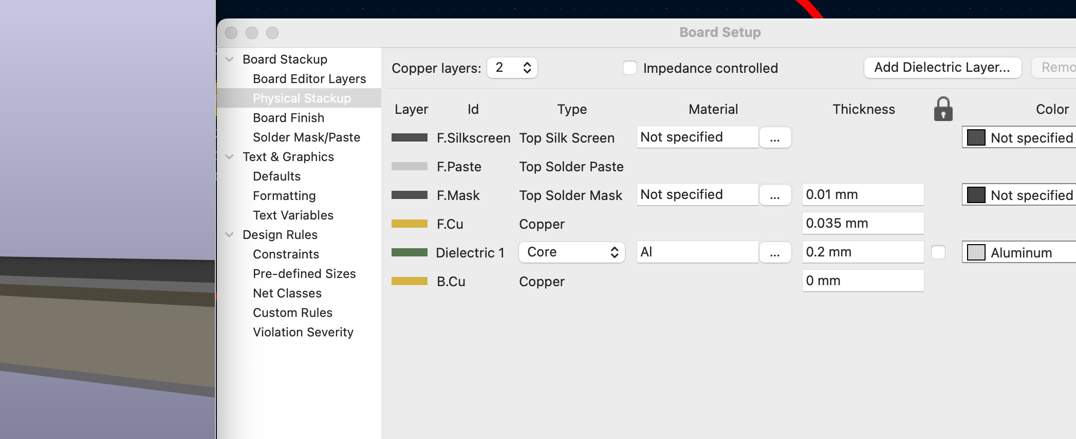

I am reworking a module for the JLCPCB aluminium core board and am wondering how to set this up in the stackup?
I have one copper layer “F”, a 0.1mm dielectric and a 1.5mm aluminium plate.
No “B” copper

The generic term for this is IMS, (Insulated Metal Substrate). In it’s simplest form these PCB’s do indeed have only one copper layer, and no via’s, but there are variants with more copper layers. And apart from the single layer, and no via’s nor THT parts I guess there is not much special for settings inside KiCad. But you could do a bit of searching to find more hints.
Experimenting with the stackup editor and directly editing the text PCB file, it looks like KiCad just does not directly support any asymmetrical board structure. A pity as these IMF boards are now becoming far more common.
I can create usable Gerber plots, but no realistic 3D rendering or STEP model

That said, you can set the B-Cu thickness to Zero and achieve some Asymmetry
You need to be able to specify multiple different non-copper layers adjacent to each other to do it properly. In the case of IMS, you need a dielectric next to a metal (not copper) layer.
For now, the solution is to just specify the stackup in a technical drawing. This works fine, you just can’t define the details inside KiCad’s stackup editor or see them in the 3D view.
