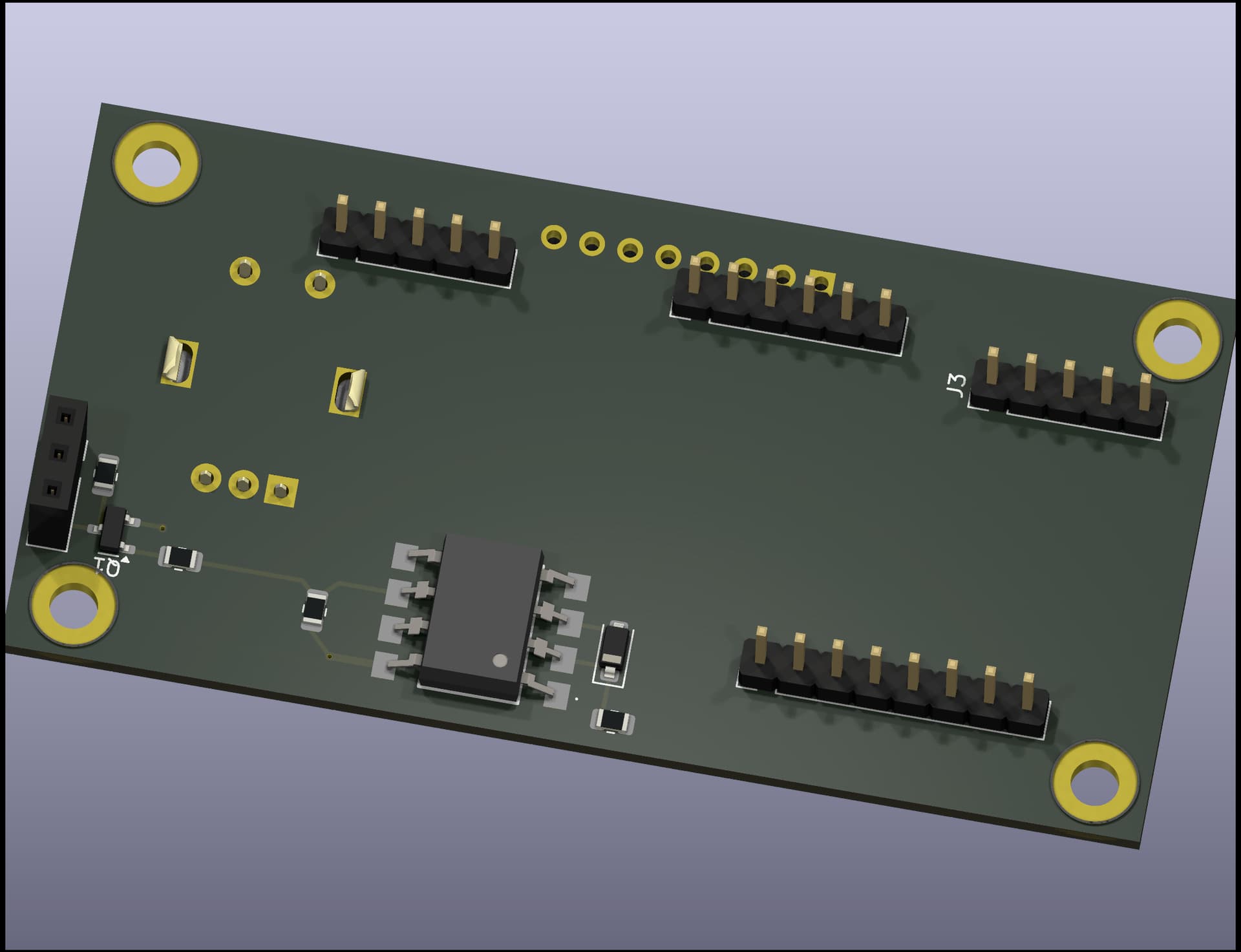

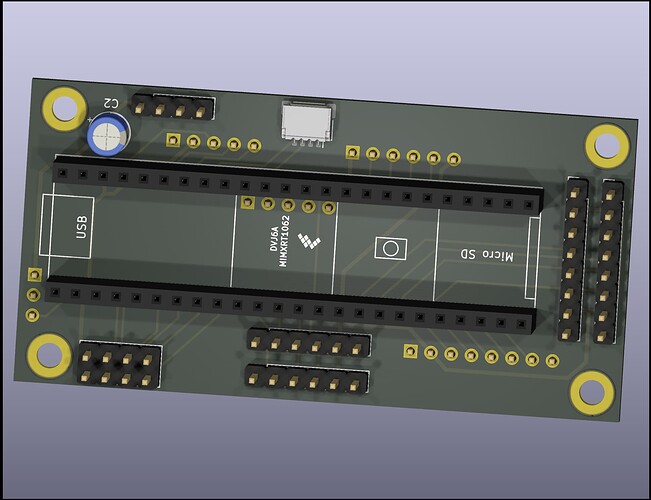

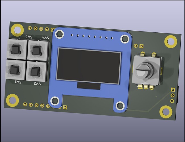

My project consists of two main boards (both designed in KiCad), held together with a standoff in each corner. Also, board A has a daughter board (actually a Teensy 4.1 microcontroller) and board B has a different daughterboard (an Adafruit OLED module). I’m really struggling with placing all the components and with keeping inter-board pin connectors aligned.

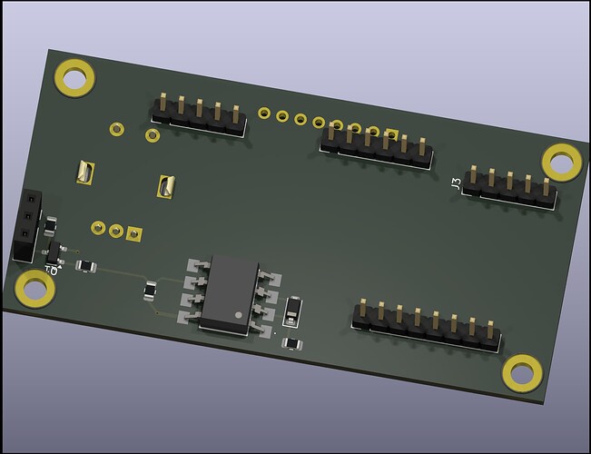

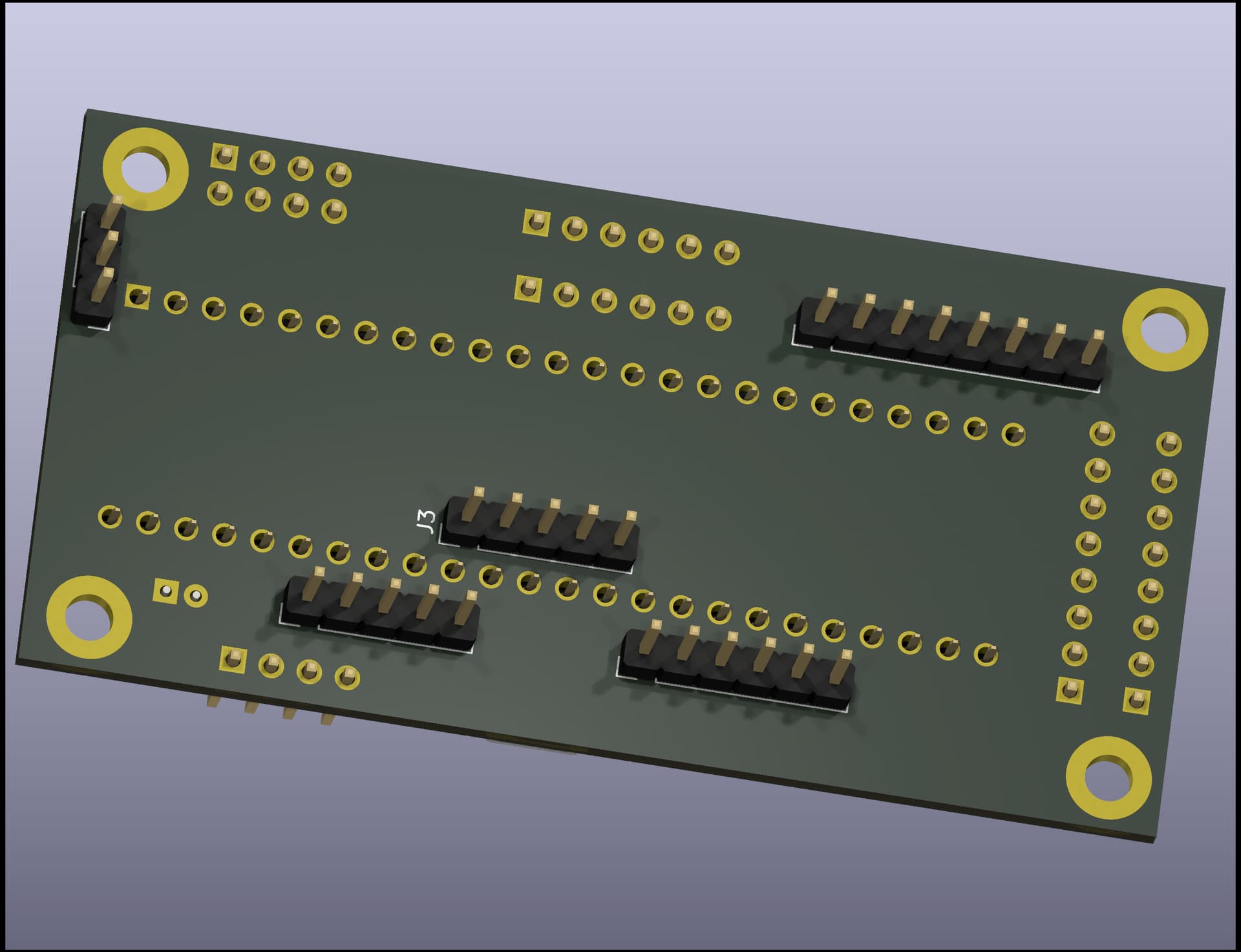

Just to explain better what I am doing, here are front and back 3D renders of the two main boards. (Not all of the pinheaders that will be swapped for sockets, have been swapped in these images)
