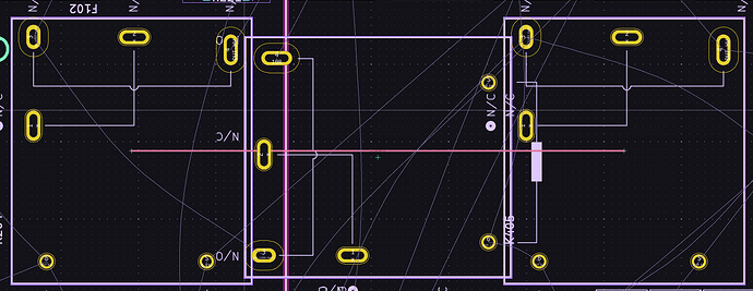

One thing that really annoys me about kicad is that when I try to align footprints, it completely ignores the pre-existing anchor point. As a result it takes everything into account, including the silkscreen components, which means things get ‘aligned’ semi-randomly and I have to manually align things. Is there a way to get it to align properly?

Correct. The problem I outlined in my OP is that, for whatever reason, the alignment tools don’t operate based off of the defined footprint anchors (or at least center of a defined courtyard). Instead, it seems to find a center of mass of all of the little bits and pieces of the footprint, silkscreen elements included. This poses a problem when I have components with little labels to one of the sides and need to align them. Since the silkscreen elements matter, all of the components are offset weirdly.
The alignment of these relays, for example, is a product of the ‘align’ functions. Note the red line demonstrating where the middle relay should be.
Are you sure these footprints are done right?
I’ve tried what you just did, but with KiCad’s default relay library and it aligns to center, perfectly.
Can you post the footprint file?
Now that I look at it more closely I can’t see the courtyard (the first thing that the align and distribute tool looks at).

The problem I outlined in my OP is that, for whatever reason, the alignment tools don’t operate based off of the defined footprint anchors.
The “whatever reason” is probably that the aligning tools are not designed to work on the anchor point. As said: for aligning footprints with their anchor points you should use different tools/workflows.
The Aligning tools are useful for aligning footprints according to their drawn shapes. If you want to align some footprints (especially different footprints with different shapes) on a board edge, then this is useful.
Obviously this works only if the footprints don’t have additional disturbing shapes drawn outside their normal courtyard. So this is a tool for some situations, but seemingly not for your usecase.
Note also: your picture is not very meaningful. At least you had to include the “additional shapes” which you think disturb the aligning tool. If you would additionally attach the archived project this would be even better - that allows to reproduce your problem and to really judge between bug/bad program behaviour/unreasonable user expectation and lastly (happens sometimes) user error.
