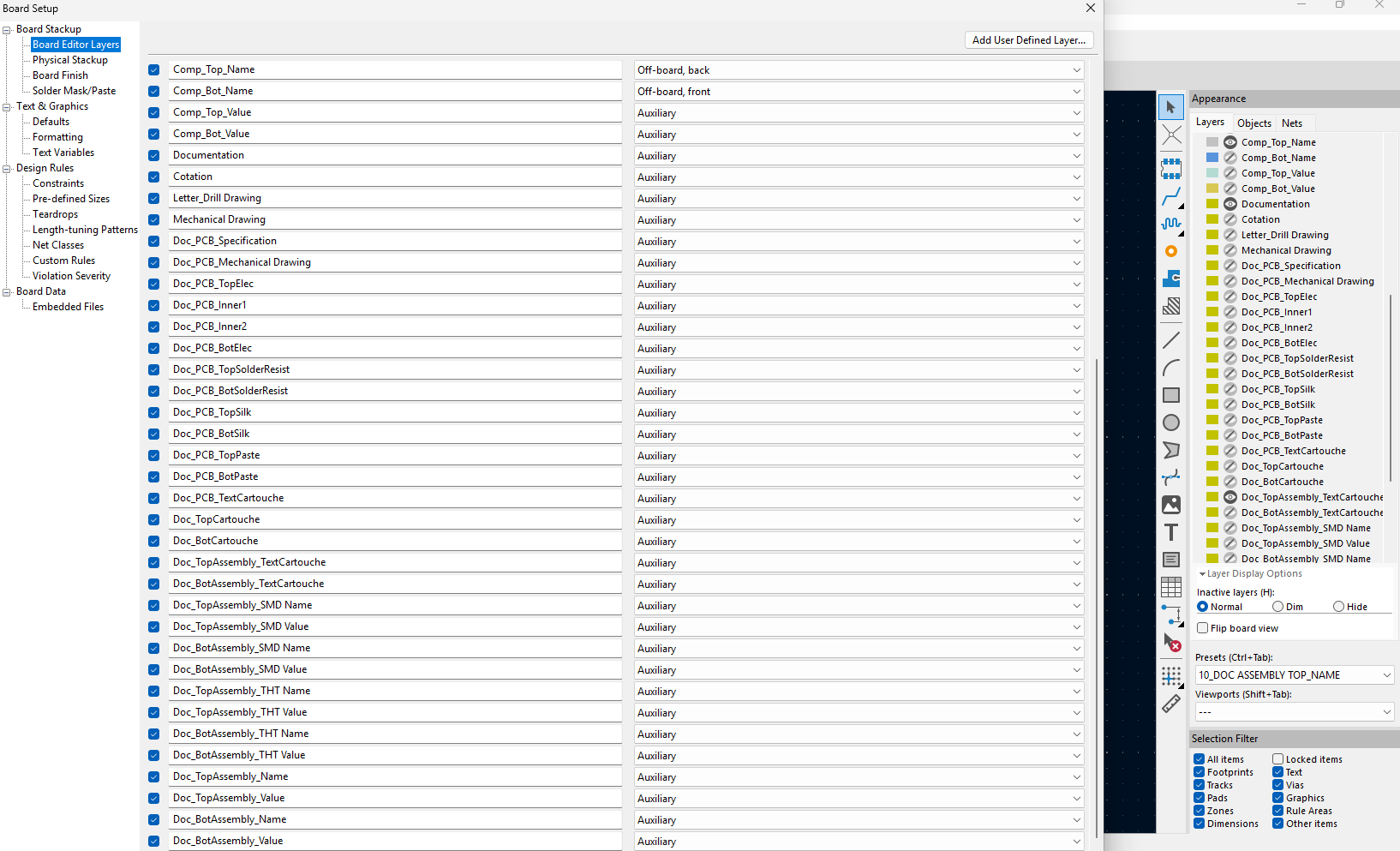

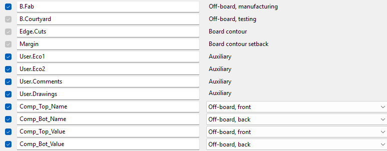

On my side, I use:
User 1: COMP TOP NAME
User.2: COMP BOT NAME
User.3: COMP TOP VALUE
User.4: COMP BOT VALUE
My library uses the User.1 and User.3 layers instead of F.Fab for Ref and Value.
Inside the Board Editor Layer, I use:
With a specific layer preset, it’s possible to quickly switch between views.
The problem for me is the limited number of user layers inside the footprint and PCB editors.
My goal was to create specific layers for THT and SMD (NAME, VALUE, PLACEMENT) in order to manage the Fab document for the subcontractor.
I come from CADTAR and with KiCAD, managing colours, layers and documents is not so easy. I need to adapt to find a solution that will allow me to easily create all the documentation for the production line and subcontractor.

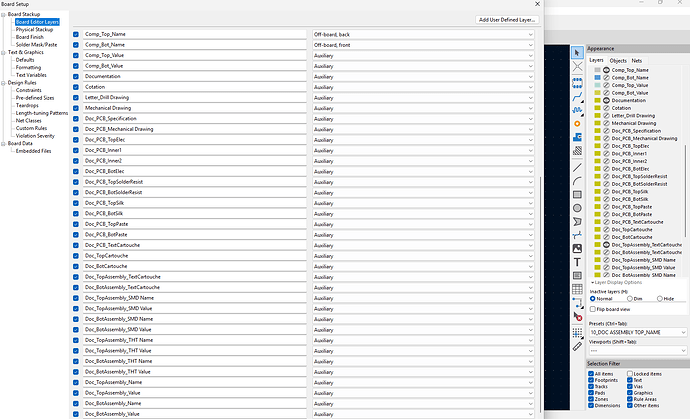

In V8, it seems that the user layers were up to user.9
In V9, we are limited up to user.4
To be able to manage the THT and SMD, ideally (in footprint editor) :
User.1 : COMP_SMD_TOP_NAME : Off-Board, Front
User.2 : COMP_SMD_BOT_NAME : Off-Board, back
User.3 : COMP_SMD_TOP_VALUE : Off-Board, Front
User.4 : COMP_SMD_BOT_VALUE : Off-Board, back
User.5 : COMP_SMD_TOP PLACEMENT : Off-Board, Front
User.6 : COMP_SMD_BOT PLACEMENT : Off-Board, back
User.7 : COMP_THT_TOP_NAME : Off-Board, Front
User.8 : COMP_THT_BOT_NAME : Off-Board, back
User.9 : COMP_THT_TOP_VALUE : Off-Board, Front
User.10 : COMP_THT_BOT_VALUE : Off-Board, back
User.11 : COMP_THT_TOP PLACEMENT : Off-Board, Front
User.12 : COMP_THT_BOT PLACEMENT : Off-Board, back
In order to complete it in the PCB editor, some layers need to be created in order to manage the documentation.
Without the capability to manage THT and SMD separately, I have:
With all the different layers, it is very important to use the preset layers function.
Unfortunately, when we use the import settings function in the PCB editor, the preset layers are not included.
The same applies to the job process function: it’s not possible to use the preset layers for PDF generation (each layer has to be selected again for each page).

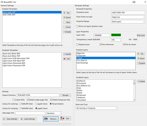

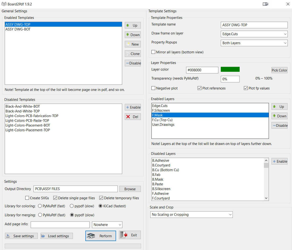

I don’t have anything to help with you trying to do layer management at the footprint level, but for PDF documentation generation you might investigate the plugin ‘Board2Pdf’. With it, you have greater control of what is on top of what, colors, transparency, etc. It’s a bit to setup initially, but once you do you can save configs and call them kinda like the new jobset functionality.
When I migrated to KiCad from PADS Layout, one of the things I found awkward was producing PDF documentation. The Board2pdf functionality provided me (mostly) what I was missing from decades of PADS.
Since I moved to KiCad I no longer generate pdf-s from PCB but I generate svg files that can be easily inserted in LibreOffice document to then make one pdf documentation file containing everything.
