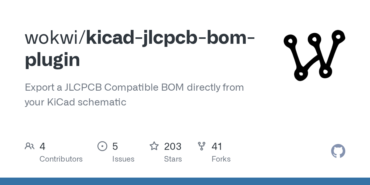

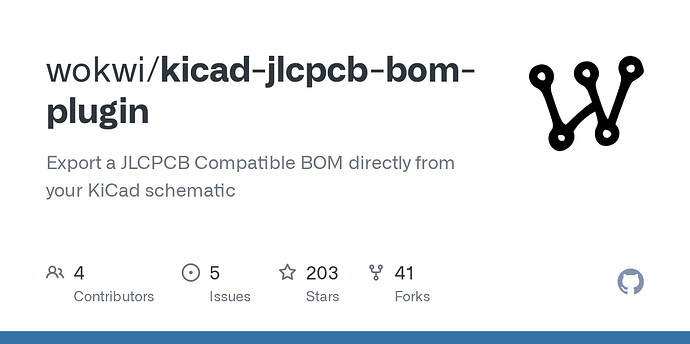

I’ve never used BOM tool, but some might find it useful, either for JLCPCB, or to fork and modify for use elsewhere:
