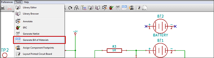

In 5.99 (the development version leading to 6.0) it’s possible to add fields in eeschema (not in the symbol editor):
Each symbol in a schematic gets that field.
And there’s project specific field, too:
Field name templates have been possible since at least v4.7
I got to know them from this tutorial and I use them since then:
or did I misunderstand something ?

I have never got this to work in ver 5.x symbol editor. I can define the additional fields in the symbol editor as in the screen shot, but when I create a new symbol those fields are not included. I believe it worked in ver. 4 and we had a discussion, perhaps even a bug report back then during the transition to ver. 5, but I cannot recall what came out of it.
I do see that those fields are added in the schematic editor, but adding them in the schematic editor is not a strategy that works well when working with fully specified library symbols that are to include all ordering information for the BOMs in standardized custom fields.
So I use the strategy of copying from an existing symbol, or one can also add fields to an existing symbol and then copy and paste the field contents from another symbol. Again it is beyond me why those defined default custom fields cannot be introduced already when defining a symbol.
