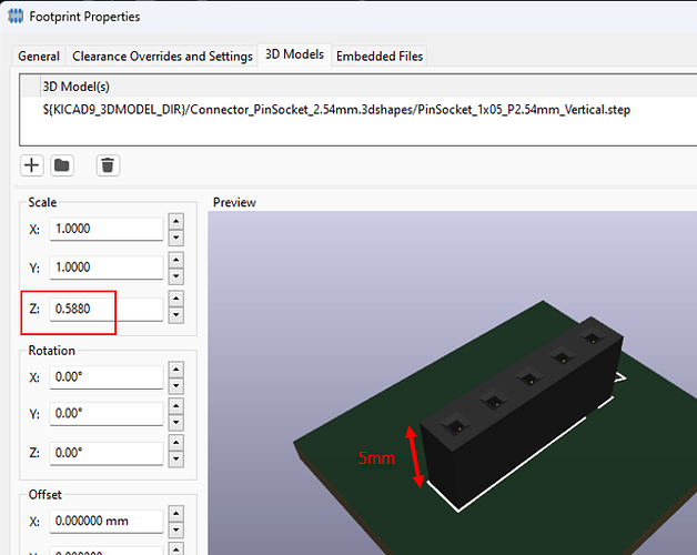

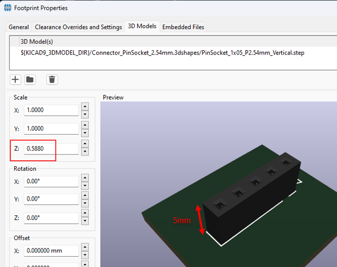

The KiCad default height for PinSocket_1×05_P2.54mm_Vertical.step is 8.5mm, but I want to use a 5mm height female header, if I scale the Z value to 0.5880 under Footprint Properties, will PCB Manufacturer understand that I am using a 5mm female pin header ?
Do I need to specifically inform the PCB Manufacturer so that the final PCB is soldered with 5mm height female pin header ?
The 3D model is just for you to assess mechanical fit, nothing to do with the PCB manufacture

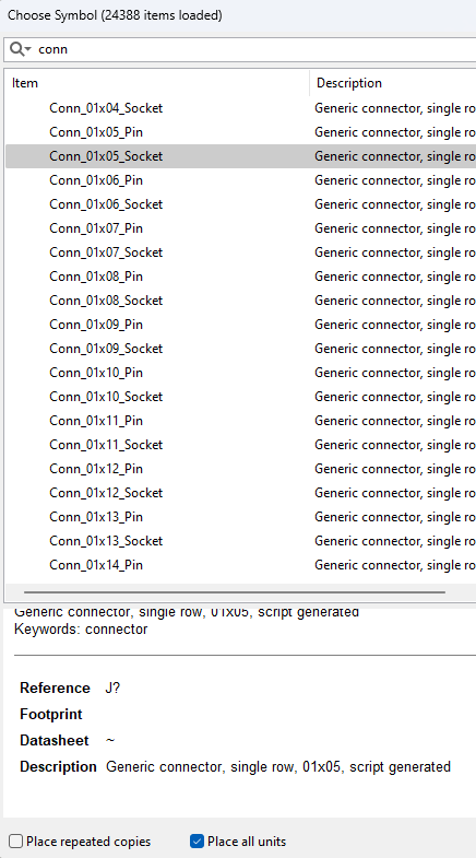

hi RaptorUK, I am aware of it but I am using the KiCad default connector where there is only general information as shown below.
By the way . . .

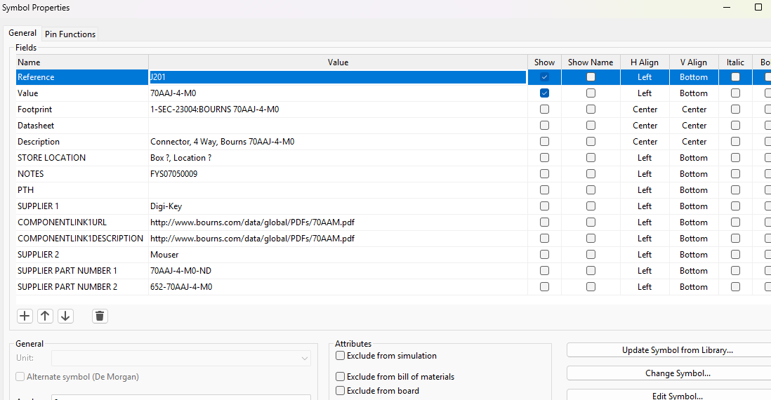

Your BOM is driven by the information in the Symbol fields not the footprint. You need to add the data that your PCBA manufacturer needs.
but the Symbol fields does not allow any editing, only the footprint properties, sorry I am new to KiCad, will try to remember closely.
”You need to add the data that your PCBA manufacturer needs.”
Thanks RaptorUK, I will try that and see will it work or not.
true as well, will have to submit and communicate with the PCB manufacturer and see. Thanks.

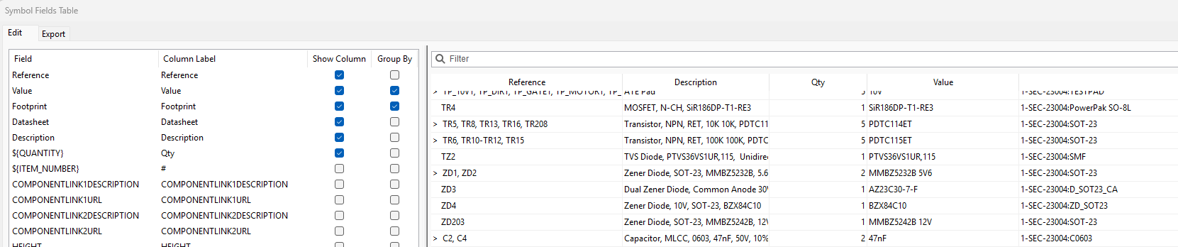

In your schematic, double click a symbol and you will see the standard symbol properties, these can be added to . . .
You can also edit these in groups, so if for example you have 20 identical 100k 0603 resistors you can change their properties in one go using the Symbol Fields Table . . .
