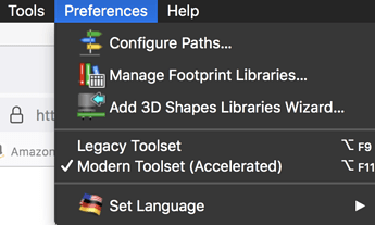

I can’t say re version 5.99 but, in previous versions, you can load a PCB, and pull down the menubar to set ‘Modern Toolset’. That will override the default of Legacy Toolset (which defaults to 45 degree snapping)
And, there’s a Checkbox in Pref’s to Limit Snapping for Legacy…
That is for V5.1.x.
V5.99 does not even have the legacy mode anymore (Or it’s so well hidden I can’t find it).
