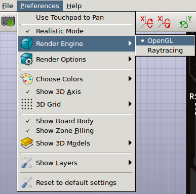

As @davidsrsb was suggesting, make sure you set the rendering engine to “OpenGL” in the preferences menu of the 3D viewer.
That’s a strange looking screenshot…This is what I have:

I am on the daily builds PPA, I think the raytracer isn’t even available on the stable version so I guess that’s not the issue.
