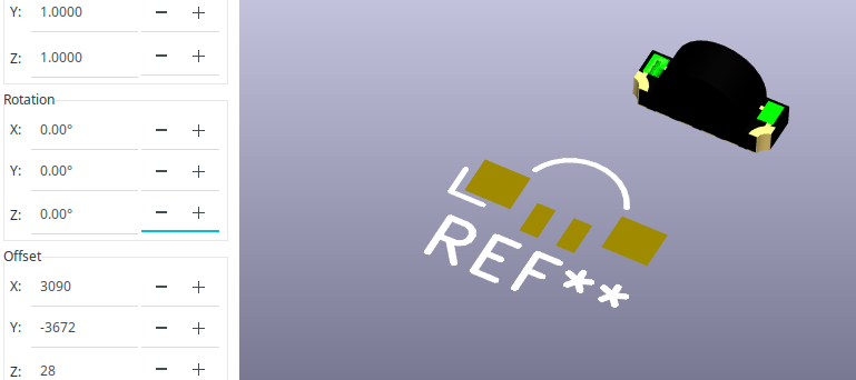

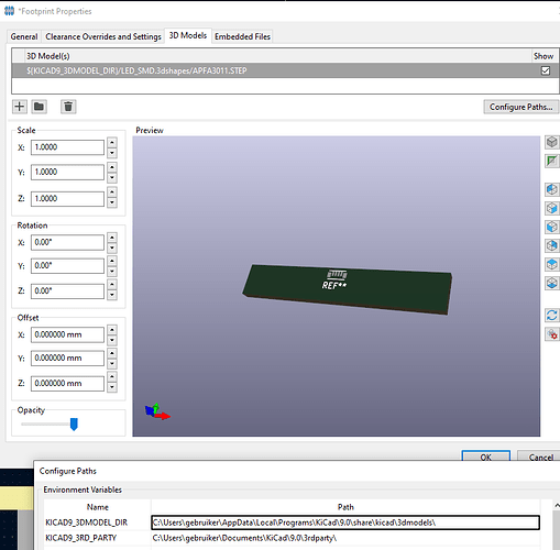

I’ve been using Kicad since 7.0 and created multiple PCBs with custom components, and full populated 3D models. This is the first time I ran into this issue that can’t be solved by converting the 3D model. Tried in Kicad 8.0.5 and 9.0.3
I want to add a STEP file from a Kingbright LED to my footprint but I can’t get it to show.
Other step files in the same folders do show.
I’ve tried:
  • Different folders
  • Importing the STEP in freecad and exporting it again
  • Converting it to IGS
  • Converting it to IGS and back to STEP
    Etc
If I open in Freecad coordinates are 0,0,0
This is the issue
Step/IGS can be downloaded here
I wanted to attach the STEP in this forum, but can’t do that as a new user.
Please let me know what I’m doing wrong…

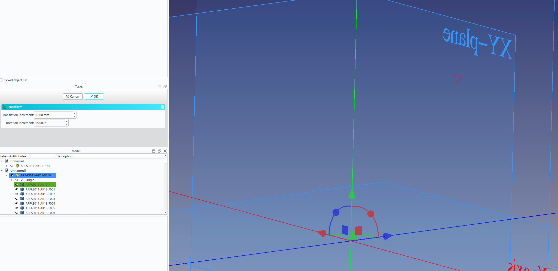

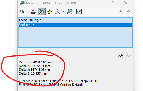

The model looks like it’s centred really far away from the origin, over 3m in each of x and y. In FreeCAD:

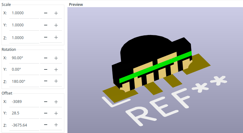

You can enter the reverse translation and it appears roughly near the footprint origin:
But as the rotation is applied first, it’s not quite that simple (a bit of paper and rotating it front of you may help, plus some trial and error):
You can also re-centre the model in FreeCAD “somehow”, but I don’t have detailed instructions for that to hand.

Yep that shows the part.
Thanks @RaptorUK and @johnbeard

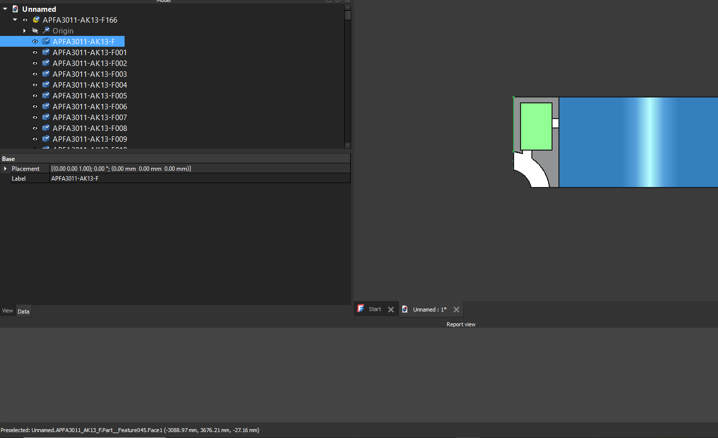

Sorry, it seems that I’ve misinterpreted freecad coordinates. (I’m not too familiar with freecad yet)
:person_facepalming:t2:

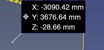

I was looking at base placement information which shows 0,0,0
Apparently when you select a part in the model tree it doesn’t show the coordinates.
But when you hoover the mouse over the actual part it shows the coordinates in the bottom left bar
