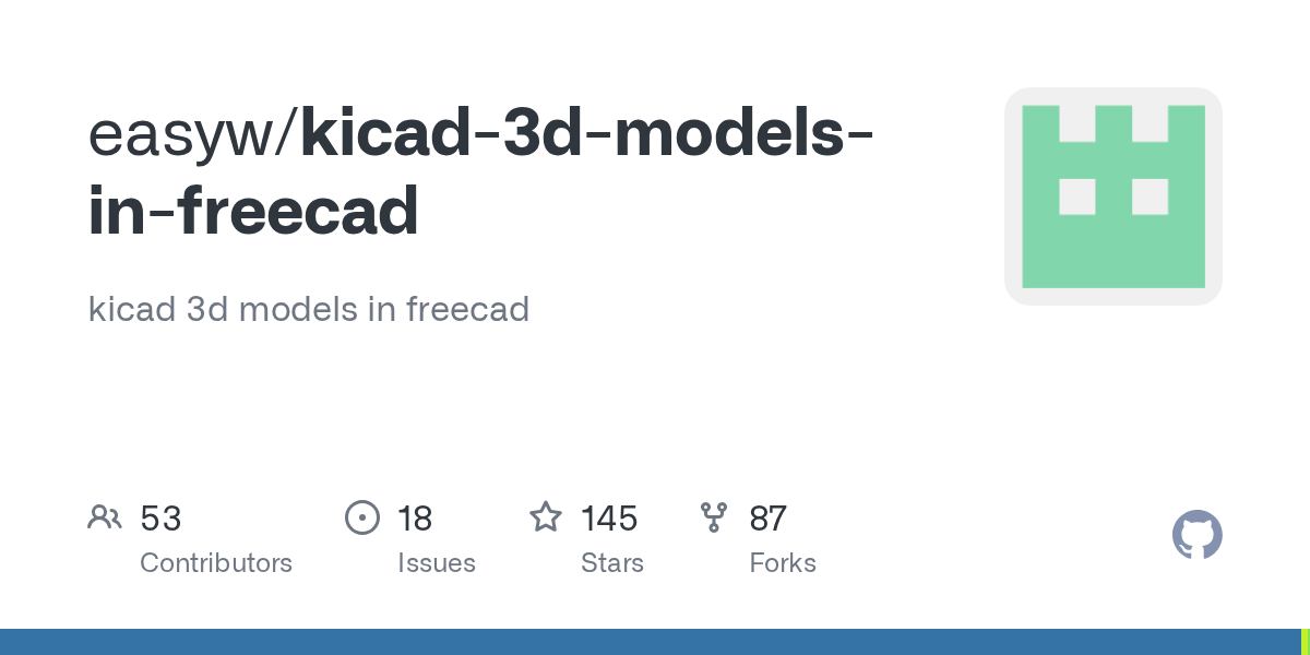

If you are not on CAD design and maybe would like something more “programatically” with parametric design (FreeCad, Python, CadQuery.. ), you can have a check this information:
That way you can create everything without using an UI or caring about STEP (it will be the product of the work, and not the source information).
@maui could help you on this :wink:
