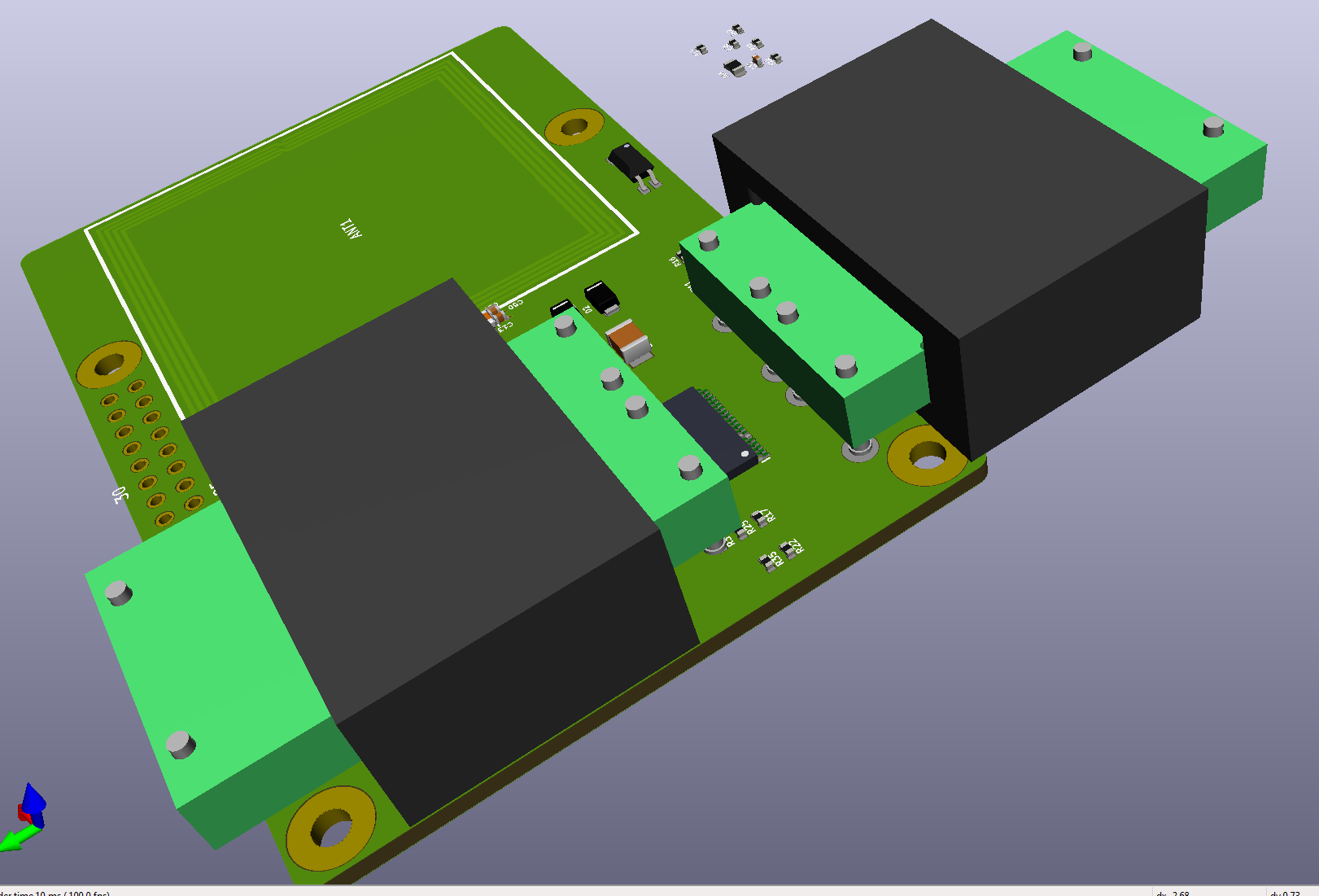

3d model get 1 extra mirrored part (SOLVED)
Looks good in freetype with the @maui tool
but once in kicad gets an extra mirrored part.
You can see left transformer is missing pads.
ps, components just thrown in, ds
I am pretty sure its a problem with the original step-file but what ?
step file attached3D 80R2-30AC-3208-1M20.STEP (248.5 KB)
Can you please attach your PCB file?
hi @nicholas
the step file attached is different from what I see from your screenshot … it is gray when in your screenshot is colored…
we could debug it, as already mentioned by @Shack, having access to your kicad_pcb board or more easily having your kicad_mod footprint and step and wrl you are using for the footprint
M
My fault
attached to another footprint also.
fast and wrong…
sorry for that and thanks for your help
