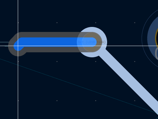

This seems easy to reproduce. Start on the bottom side, hit V etc and click and it continues to route on the bottom side. It seems to work if I start routing from the top side. It checked to see that the bottom and top layers are paired (though the inner layers are not). Also vias can’t always be moved after being placed!? Sometimes you can drag a via and sometimes you can’t?
(Use a Mac with version 9.0.4) It makes it slow and tedious to route traces. When I seem to get it to change sides when routing from the bottom I end up pulling another via around? V to get a via then another click place it, then it doesn’t continue routing?? When I click again on the via it starts to route on the same side as the via again. What could I be doing wrong? Is there something wrong with this set up? There must be something seriously wrong. This is my first layout with KiCAD. I’ve got like 30 connections made. There’s no way I can work this way for the next 400 connections on this board. It’ll take weeks!!

  • Placing a via should continue routing on the next active layer in the layer pair. Have you got the layer pairs set up OK? The active layer pair can be edited from the menu bar layer pair button.
  • Vias should drag just fine, with the D or G hotkey - but the behaviour of how existing tracks move is different between the two modes.
I’ve just checked this with my local 9.0 install with a new project, and everything works fine. Perhaps you could post a video of what you’re seeing, with a description of the exact steps?

I apologize if my approach is a little brusk. I’ll try to edit out my unecessary comments in the post. I’m in between trying to figure out it the behavior is normal and I just don’t know how to use it right, or if it’s a bug. The V key was not switching layers for me. I got the top and bottom layers paired before I wrote it up but I didn’t pair the inner layers until recently. Originally I thought the top and bottom paired automatically. Perhaps I also needed pair the inner layer too, and then disable them? Was this what now allows me to reliably switch layers? So the layer switching is OK for me now. Thanks for the replies. I’m just trying to figure this out.

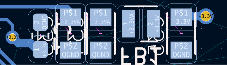

But I’m still not sure why the vias don’t move when I hit D or G. They unselect themselves when I hit the key. For instance. The below selection I could grab with the vias and then drag with a mouse click or M, but the traces disconnect. When I tried it with D or G, the vias the traces connected to the vias unselected them selves. I was trying to moving everything with its vias and traces closer to the CPU

There is a difference between Move and Drag. Moving just moves items (footprint or a selection) It does not maintain any sort of connectivity
You’re also mixing up several things in one block of text (which is something that easily confuses me).
If you have a via placed, you can click on it, and then drag it around with the mouse (no key whatever needed). and it will keep the tracks attached.
If you click on a footprint, and then “drag” it around, then KiCad defaults to the “move” function, and it gets detached from the tracks.
If you hover over a footprint (no need to select it first) and then press d for drag, then KiCad drags the footprint, and it keeps tracks attached. KiCad won’t accept an end position that violates DRC, but you can overrule this by keeping the [Ctrl] key depressed while finishing the drag. And similar for blocks. Creating a selection, then d drags the block around while keeping tracks attached.

  1. Starting a track.
  2. Press V to attach via to the cursor
  3. Click to place the via and continue routing on another layer
… did not work for you. Does it work now?
I am not so familiar with the layer pairing. I have not designed a PCB with more then 2 layers yet myself.
The V function does seem to work for me now. It seems I need to hit V again to switch layers (now that I have all layers paired properly) which I thought would happen the first time I hit V. I’m also able to work by just selecting the new layer (similar to my old way of working in Eagle.) So it seems more workable to me now, but not entirely as expected.
I was unaware that drag worked differently whether it was hovering over a component vs one that was selected

Not really different, but without selecting, you can just drag one item. If you make a selection first, the whole selection gets dragged.

There are many hotkey options that do not have a default key assigned, but not for extra dragging options. You can drag a block (with whatever is in it at that moment). There is a significant difference between between dragging the mouse cursor from left to right, or right to left when you create the block. (Left to Right does not include the items that cross the block boundaries)
For the rest, maybe you are struggling with the Selection Filter in the lower right corner. With it you can set the object types which are selectable.

BTW I figured out my biggest problem. REVERSE THE ORDER OF “V” AND CLICK! It’s habit! For 30 years in both programs I’ve used I’ve placed the point where I want my via first with a click, then changed sides or placed the via with a command or hotkey. With KiCAD I hit the V first, THEN place the location with the click. If I click first then V with KiCAD it places the via, but it does not change side until I hit V a second time. It took me WAY TO LONG to figure this out. I knew this intellectually and could start working fine, but my fingers brain kept reverting. I thought it was some inconsistent bug. It’s my brain!
