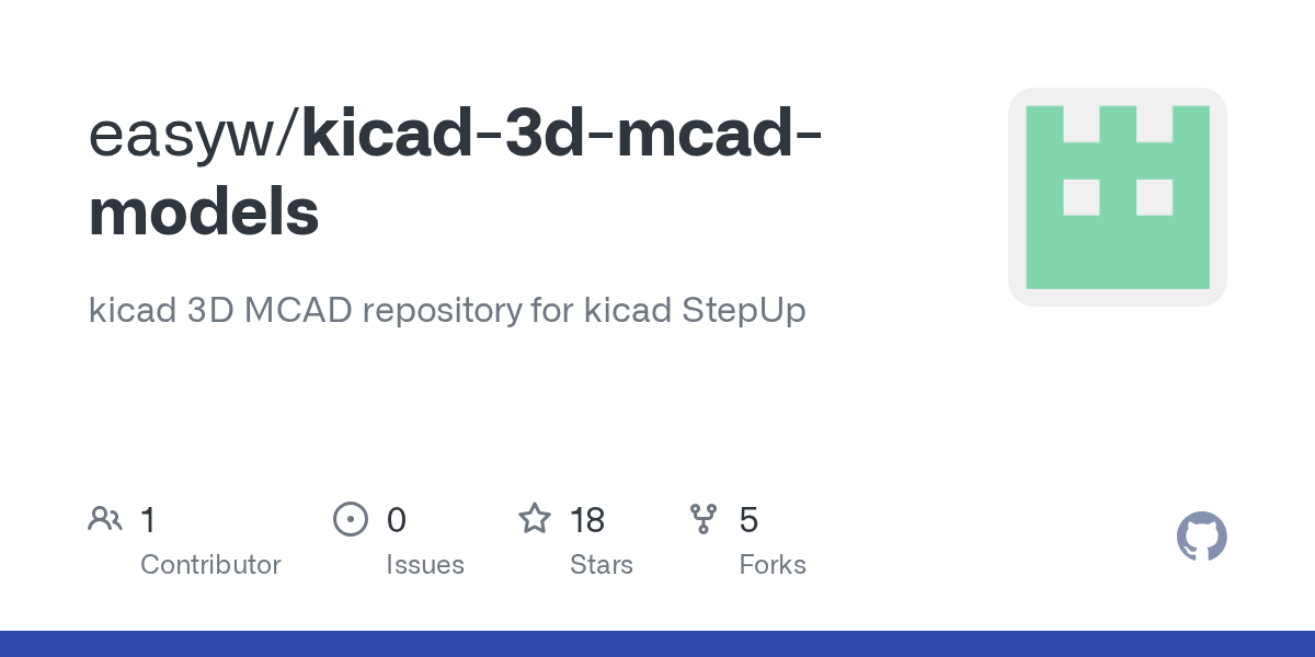

Anyway … if you are planning to use STEP MCAD models, there is a consolidated road to use them also fine with old 4022 stable release…
please have a look here for the STEP mechanical exporter
and here for a lot of library models already tested for kicad
and some ready to go 3D libs
3D kicad libraries List:
Resistors_SMD.3dshapes
Capacitors_SMD.3dshapes
Capacitors_Tantalum_SMD.3dshapes
Housing_SOIC.3dshapes
Housings_QFP.3dshapes

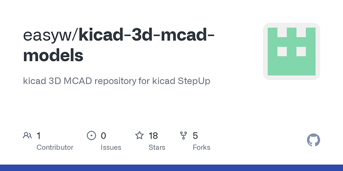

Hi @Tim_Wescott
have you tried the wrl at these libraries?
ResistorsSMD.3dshapes
CapacitorsSMD.3dshapes
CapacitorsTantalum_SMD.3dshapes
HousingSOIC.3dshapes
HousingsQFP.3dshapes
are you working with 4.0.2 stable?
they should be fine with the stable release…
moreover you can have a look at kicad StepUp… inside the StepUp tools there is a button (function) to export FC 3D models to kicad wrl compatible with stable and dev branches…
please let me know if you have any issues…
