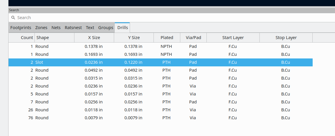

Drills tab in the PCB Search panel.
Selecting a row will select all of that type, so you can modify them quickly with the properties panel.

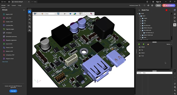

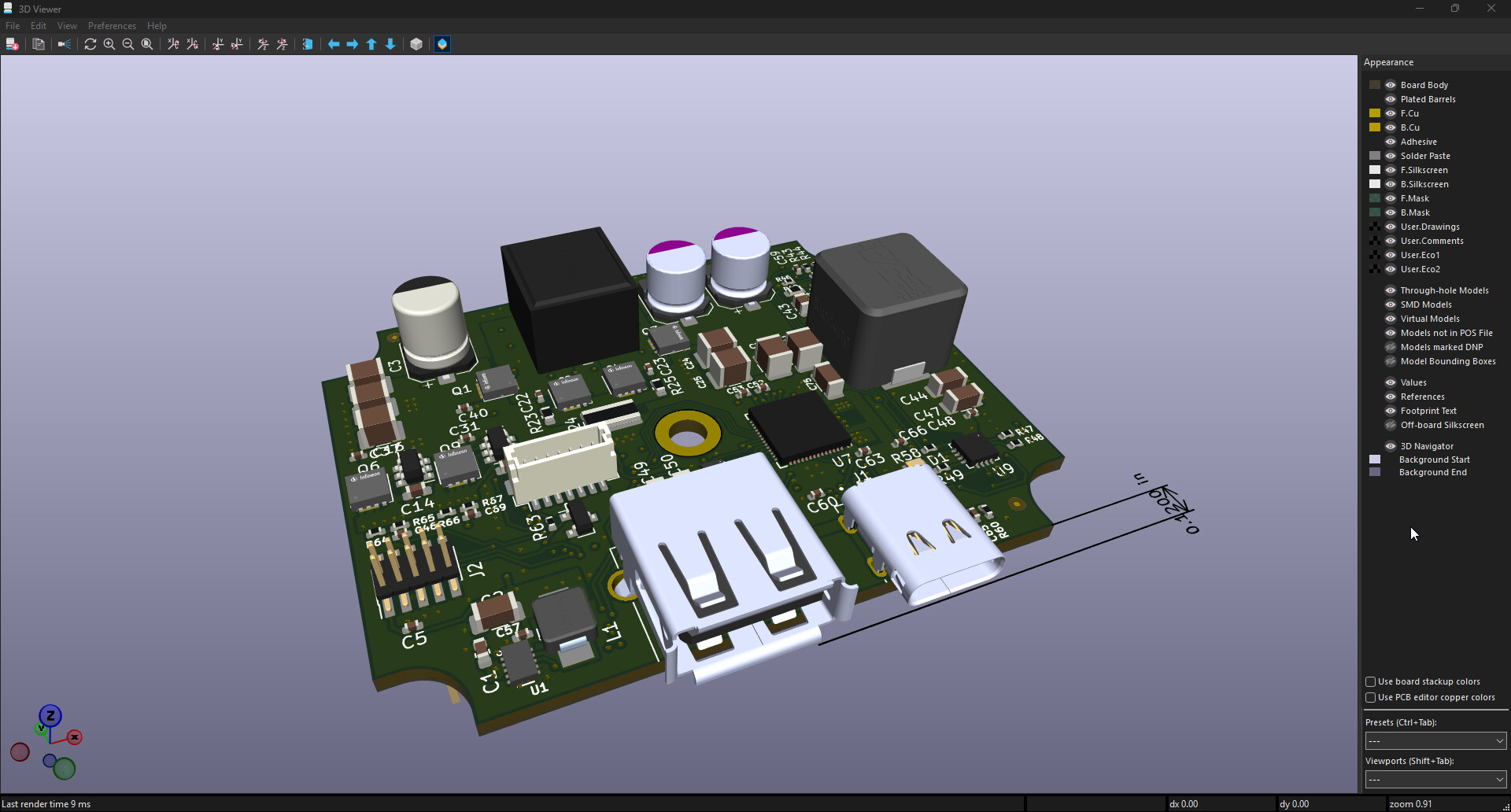

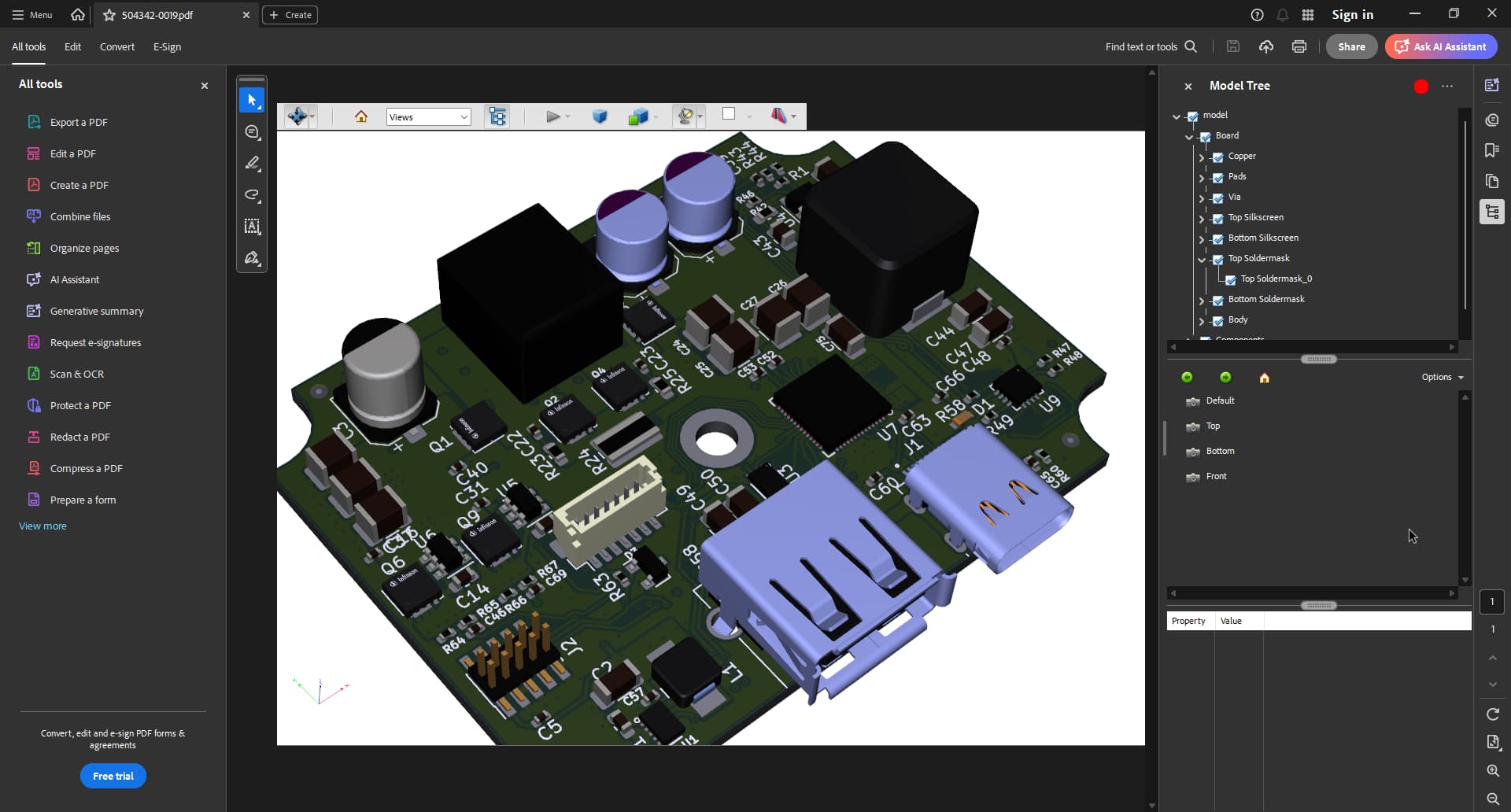

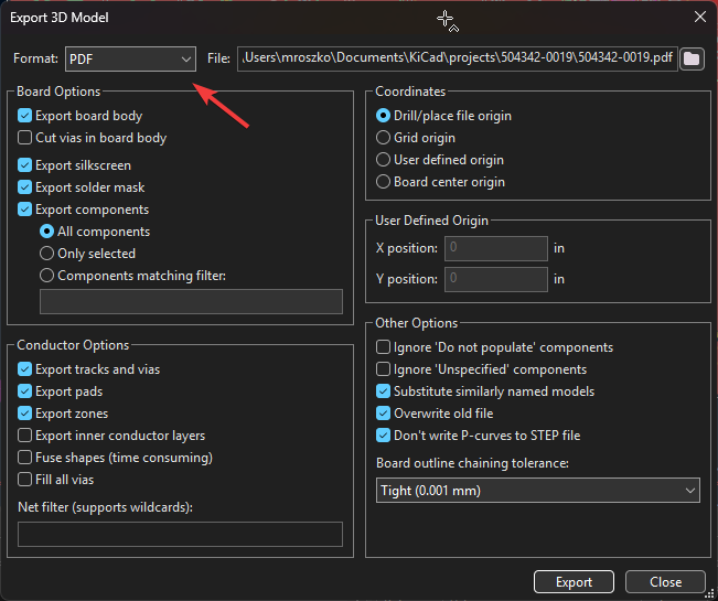

3D PDF File Export has been added. Sponsored by the NLNET Foundation Grant for 2025.
Which is available as a PDF option in the “Export 3D Model Dialog”
3D PDF is limited to PDF viewers that support it. This generally means Adobe PDF and Foxit.
Browser based viewers do not fully implement the PDF standard.

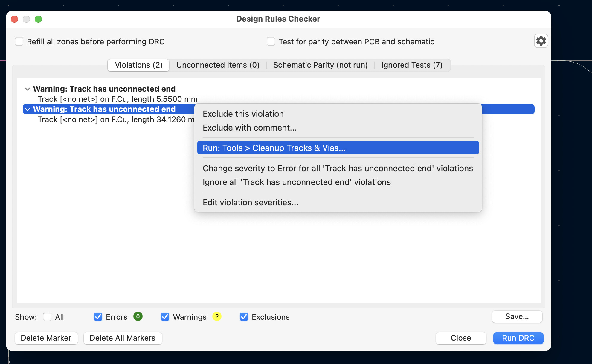

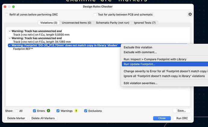

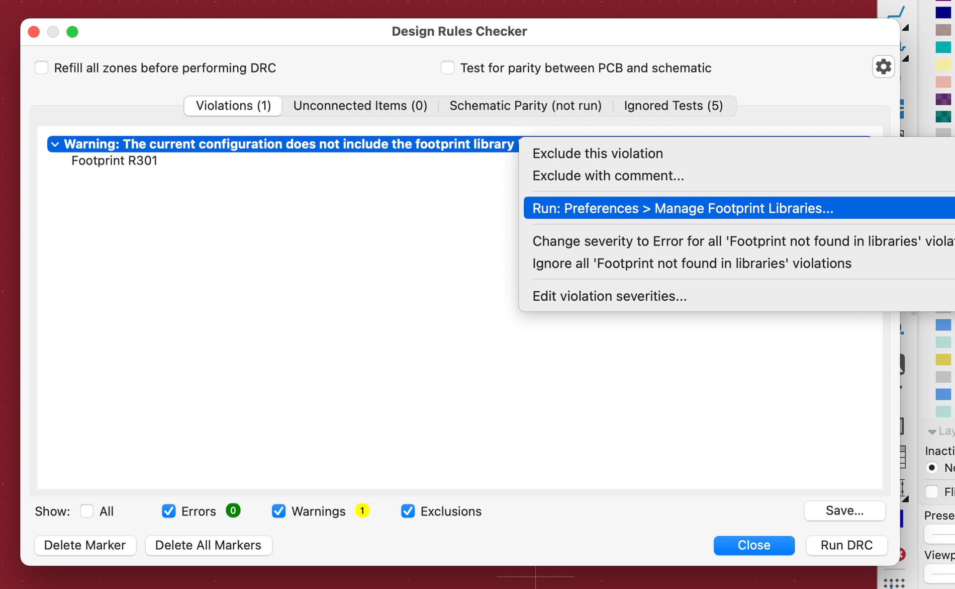

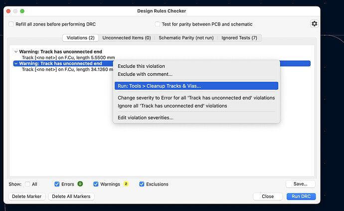

Lots of ERC and DRC errors now have fix actions:
Full list of errors with actions:
DRCE_LIB_FOOTPRINT_ISSUES
DRCE_LIB_FOOTPRINT_MISMATCH
DRCE_FOOTPRINT_FILTERS
DRCE_SCHEMATIC_PARITY
DRCE_MISSING_FOOTPRINT
DRCE_DUPLICATE_FOOTPRINT
DRCE_EXTRA_FOOTPRINT
DRCE_FOOTPRINT_TYPE_MISMATCH
DRCE_FOOTPRINT
DRCE_PADSTACK
DRCE_PADSTACK_INVALID
DRCE_TEXT_HEIGHT
DRCE_TEXT_THICKNESS
DRCE_MIRRORED_TEXT_ON_FRONT_LAYER
DRCE_NONMIRRORED_TEXT_ON_BACK_LAYER
DRCE_DANGLING_TRACK
DRCE_DANGLING_VIA
ERCE_SIMULATION_MODEL
ERCE_FOOTPRINT_FILTERS
ERCE_FOOTPRINT_LINK_ISSUES
ERCE_LIB_SYMBOL_ISSUES
ERCE_LIB_SYMBOL_MISMATCH
ERCE_UNANNOTATED
ERCE_DUPLICATE_REFERENCE
ERCE_UNDEFINED_NETCLASS

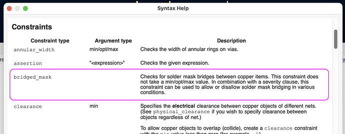

New bridged_mask constraint type for custom rules.

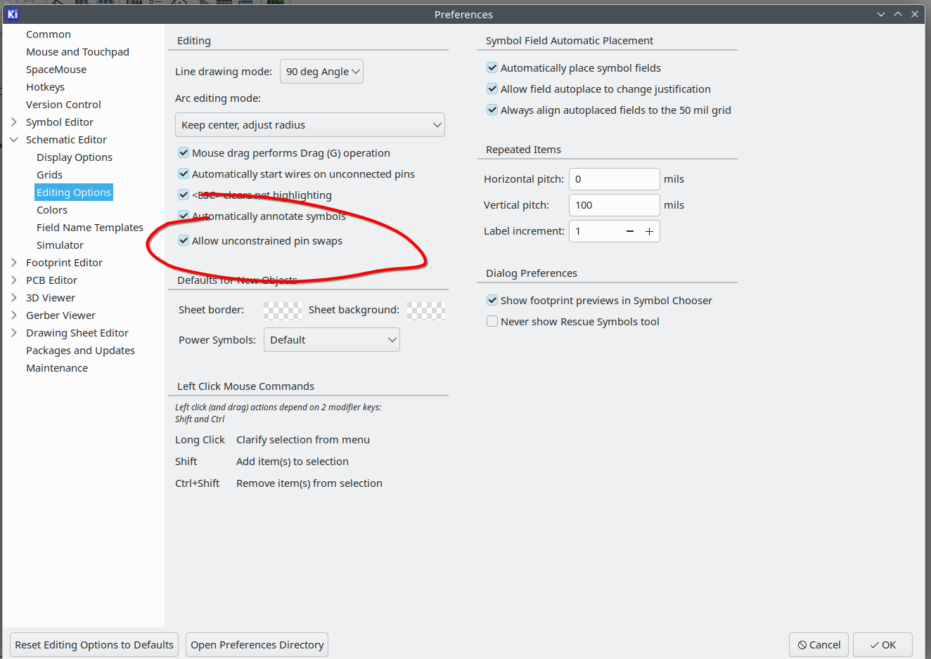

As an addendum to the unconstrained gate/net swapping, you can now swap symbol pins if you choose to enable this setting:
This feature is not without risks, as it will modify your schematic-local symbols to not match the library symbols, so it is disabled by default. (Similar to free pads mode in the PCB editor).
This also works when transferring changes from the PCB to the schematic to due pad net swaps. You will have preferential control over whether this type of swapping is preferred, and also informational output when the swap cannot be performed.
