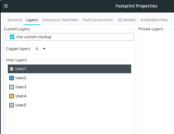

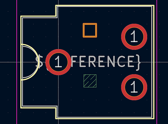

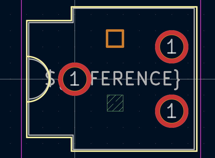

Footprints can now specify objects on defined inner layer, and can also opt into any set of user layers rather than just four. E.g. this footprint has a shape on In2 (orange) and a rule area on In1 (green):
To use this, you must define a specific stackup for the footprint by choosing the number of copper layers and adding any user layers that you want.
Layers are 1:1 with the board layers. Objects defined on layers that don’t exist on the board are not shown, but remain in the footprint on the board and will be used if you increase board layers.
If you do not set a stackup, the default is the current behaviour where rule areas on In1 are “expanded” to all inner layers.
