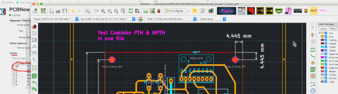

I would like, to understand if this is something can be done in KiCAD directly.
If not: yes your macro is partial but effective solution

It’s not a perfect solution. But, I call several external App related items from a Plugin.
Example shows calling LibreCalc (from a Kicad Plugin at Top-Right). That opens LibeCalc and from there, can open desired CSV/other and do the rest of the needed stuff…

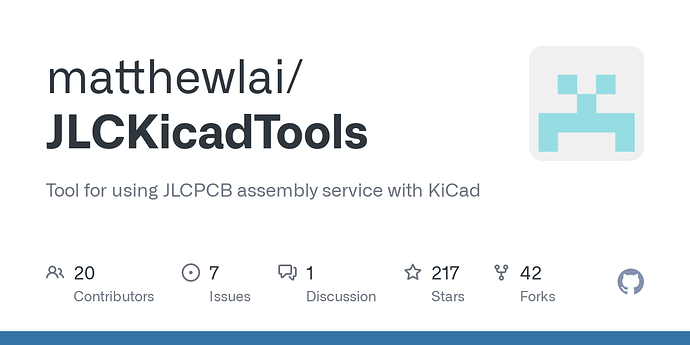

I recommend spending some effort on using KiBot. I use it with the dev docker container.
There is a sample configuration to export the position file, but you can actually automate exporting the gerber package, BOM and positioning file.
Once you get going with KiBot, you’ll appreciate many of the other tasks it automates and the power of selecting components through variants on all production and documentation outputs.
I don’t work with 5.12 I am using v6. It’s at RC1 stage and very stable and has considerable improvements. My BOM script will bridge me through to later this winter if/when KiBot adds v6 support.
That’s right. Although it’s not exactly my intention to install even PERL just for this purpose. I mean: this will be the only one reason for which I do use Perl. Not justified … Conversely, a script that’s running directly into KiCAD environment, will be better (in my case)
