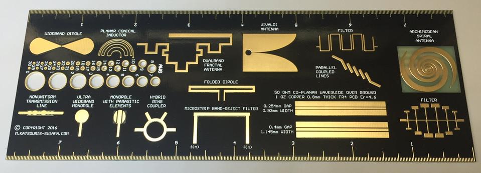

I tend to do a lot of RF work, so the ability to make complex curves like that would be very useful. Normally for tracks of course rather than board milling. Kicad can’t easily do this as far as I know. Something like an interdigital PCB filter would be very difficult to draw. Some examples in this link.

for RF footprints, you may consider to have a look at here
