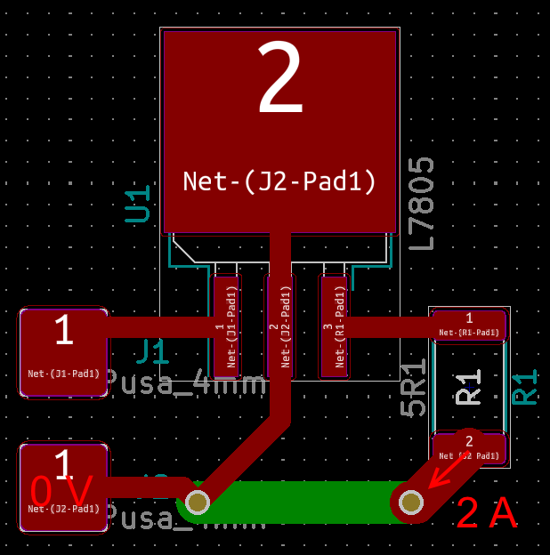

I’ve got a simple layout:
Pad on lower left has potential of 0 V and from R1 we expect 2A current to flow. How much voltage drop are we going to have across thick trace on the bottom layer?

As you can see the voltage drop on 10mm long, 2mm wide and 0.035mm thick copper trace with 2A flowing through it is about 0.005 V (0.0105 - 0.0055). Which is about what KiCad’s calculator gives:
So DC PDN is doable but there is a lot of manual work and the presentation of the results is somewhat spartan.
