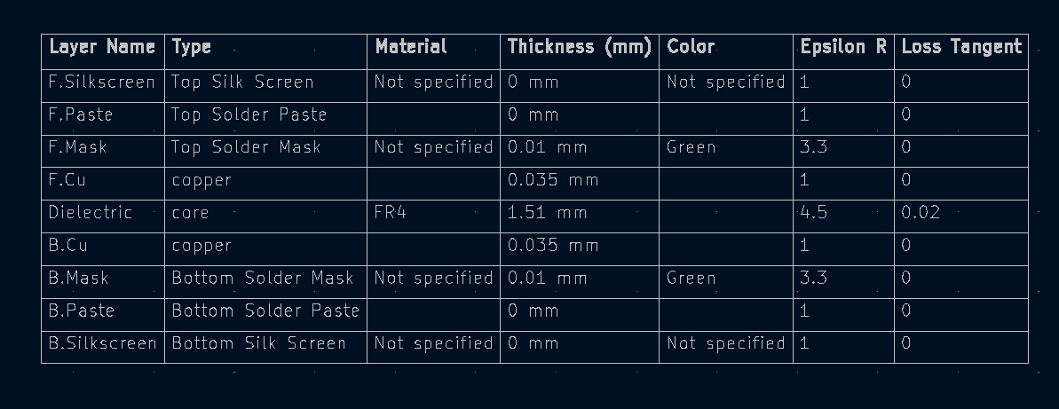

I do something similar but I put it off the board so that the board house is sure which layer is which. I’ve found that if I have mixed up layers it has been because of pour documentation on my part. Though I do like the idea of putting it on the board, this could be useful for incoming inspection. If you have inner layers you might have to dig or x-ray the board to tell if the layer is in the right place. It does suck to have inner layers mixed up when RF performance is dependent on there position.
In KiCad you can set up the stackup in board setup and then use Place → Add Stackup Table.
This looks like a new in 6.x feature that I haven’t explored yet.
