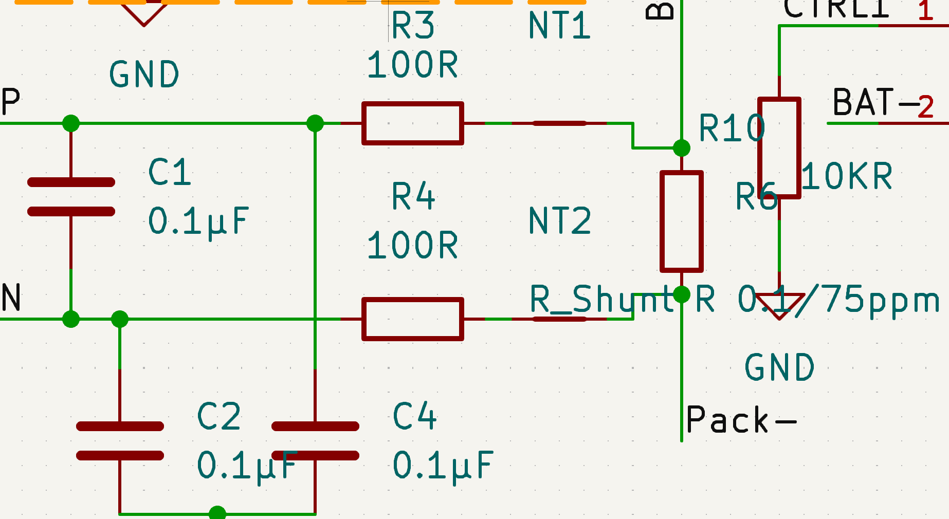

Net ties are separate entities. You add them to the schematic as separate symbols, and you assign footprints to them, just like any other footprint. The footprints for net ties, are just two (or more) pads connected with some copper.
To show an example, the project below is made entirely out of symbols and footprints from KiCad’s default libraries.
Here is the schematic:
And a possible PCB layout:
The intermediate width tracks are from the net ties. I have placed them in such a way that one pad is on the pad of the SMT resistor, while the other is free to connect a track to.

It helps a lot, thank you!! I understand now how to create nettie and use them for the kelvin connection! Thank you! Here is the obtaind result :

To be more clear: schematic:
ShuntSch
