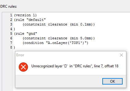

I’m also concerned about the error dialog you did get not reporting the layer name correctly (the box between the quotes means “unknown character”). What locale are you using?
Dear Jeff (@JeffYoung) , I am using locale de, so Germany. I guess the error came from the non finished implementation. I guess its not to crucial for now.

The dialog does not to seem to be fixed for now. So correction of myself, it’s an issue=)

Tested again (version kicad-r16539.0fecb5f27-x86_64.exe) ,and the error message looks different now. Have a look at the large offset. May it be, that something is not initialized. (And to be honest, it should not show an error, here, i checked, everything is fine. Maybe this gives you a helpful hint.

Well, that’s annoying, although I was pretty pessimistic about that fixing it. But it’s definitely a multi-byte issue of some sort.
Tom’s going to look at changing the parser’s internal datastructures from char to either wchar_t or wxString (which is wchar_t inside). Stay tuned.
