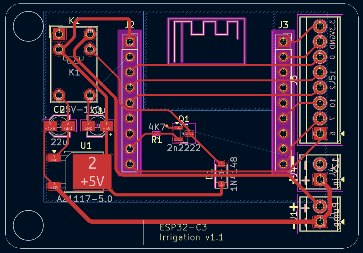

Alright, spent some time on trying out a pcb.
If understood everything correctly, low current signals are using a track width of 0.3mm and should be enough. 5V is at 0.5mm and 12V is at 0.7mm.
According to calculations it should be enough, i suppose the 12V tracks can be made bigger, there are plenty of space around them.
The back is ground except for parts under the ESP. I’ve read somewhere at some point that a ground backplate under the antenna might not be good for reception.
So what are the thought’s on this?
Oh, and yeah, there are a few silkscreens overlaps i have ignored for now.
Two major things:
The diode has to be placed as close as possible to the relay’s coil. Best place would be on the back side.
And I’d place the relais close to the screw terminal. Thus horizontally on the bottom.
Edit, adding a third major thing:
You should add a fuse.
C1 woulld be better placed below U1
Ah ok. I see a few changes i can do with that.
I could probably move both 1x2 screw terminals to the other side. Getting the pump one up by the relay, and 12 volts in next to the regulator.
I’ll post a new one shortly.
Alright, things are grouped a little differently, the longest tracks are the GPIO’s going to the screwterminal.
I could switch out J2-8 for J2-3.
Edit: I keep forgetting posting the picture
OK!
As you do have a GND zone on the back (if not, make one), remove all the GDN tracks on the front.
Place a via at C2 pin 2 and C1 pin 2. This might enable some better routing. And maybe (more maybe not) place D1 back on the front, just for convenience while assembling.

I’ve heard this often, but never got any decent reason for it. Best I know, it’s a stubborn misconception. If you’re optimizing for EMC, then the best place of the diode is close to the “switch”, because it minimizes the change in the path of the current takes. A DC current is no EMC problem, but changes in currents (and current paths) are important for EMC performance. For more background info, research with the magic words “hot loop” in SMPS design.
Because of the inductive nature of the relay coil, changes in current though it will be relatively slow (and thus generate not much EMC problems in the first place, but switching the long current path from the transistor, to the diode is a fast change. You do not want a big change in loop size for this current.
The keepout area around the antenna looks a bit small. In general, more empty room around then antenna is better. There are some recommendations for this, but those should generally be treated as a minimum. I guess you have (relatively high) headers in between your PCB and the ESP32. This also “complicates” the effectiveness of the keepout area for the antenna. It also looks like you have an edge of the zone coinciding with a keepout (rule) area. I don’t like such constructions. KiCad uses integers, and those don’t have as much rounding errors as floating point numbers, but I still prefer to avoid the possibility of rounding errors to cause a problem. I would just add a few more corners to the zone, and not use the rule area at all.
G5V is a quite small relay, with a maximum current of 1A. Your:
probably has a higher peak current. Maybe it’s good enough, maybe your relay fails after some time… (months, years).
Well, here is my explanation.
Lets say, the transistor is “far” away from the coil.
You switch on the transistor and that transient travels along the path, emitting noise. That is an argument to place the transistor close to the coil.
Now if you switch off the coil, you get an inductive transient, that travels from the coil to the diode, so same effect as with switching on.
The voltage generated by the coil depends on dU/dt (switching time). So for both cases, a slow switching time helps to reduce noise. And placing the transistor close to the coil reduces EMI when switching on. The diode close to the coil reduces EMI when switching off. Furthermore, the voltage generated by the coil mostly is higher than the coil driving voltage.
Is that good enough?

Seems my editing didn’t reach you: I suggest adding a fuse. If the motor gets blocked, your relais will overload.
And an extra suggestion (that you might ignore) is reverse polarity protection. At least in front of U1/C2. A voltage drop from the diode doesn’t hurt the supply to the ESP.

So your main goal is concerning EMI. So that’s a point we can agree on.
Voltages really do not have much meaning when inductors are involved. It’s much easier to understand circuits around inductors when you primarily look at the currents, and for EMI, you have to consider of how those currents change in the circuitry. DC currents (and voltages) don’t matter for EMI, but changing currents (and voltages) do. Placing the diode at the location of the switching element (transistor) is the best location. Maybe read my post again.
Why would there be a “transient”? (you’re probably looking at voltages).
Now turn it around, look at the current:
When the transistor switches off, there is no transient, current through an inductor is always a continuous function. If you try to disrupt the current, really weird things happen to the voltage. So where does the current go? The transistor is off, so it goes to the diode instead. If the diode is close to the relay, then the tracks in between the diode and the transistor are suddenly without current (Bad for EMI). If the diode is close to the transistor, then the PCB 'tracks just keep on conducting the same current (which decays after a while).
I thought about the fuse as well. But what happens when the motor is blocked (or wires get shorted, etc) really depends on the power supply. Fuses are good, but no need to exaggerate.
The underside of the antenna should be cut off, or the antenna should be protruded out of the board
If you add a fuse that only protects the motor, the ESP still works and even could monitor the voltage to the motor when switched on and thus detect a blown fuse remotely.
