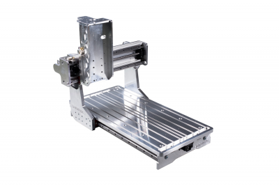

If I were to buy a router, it would very likely be along the line of a Sorotec Compact Line:
But beware, these machines are around EUR2500, and that is just the mechanics without the stepper motors, electronics to drive them and a spindle motor.
BlackCoffe bought his machine as a toy, and that is exactly what I consider that level of machines. But I do acknowledge that toys can be fun to play with :slight_smile:

@00:30 these are the rods I mean.
Those shiny steel rods (probably 16mm) are not stiff at all and bend far to easily because they are only supported at the ends.
I have used the TBR16 rails, which are supported over the whole length, and therefore they transmit the forces to the frame itself, which makes the whole machine a lot more ridgit. “My next machine” will have the square type of rails, just like the Sorotec I linked to earlier.
