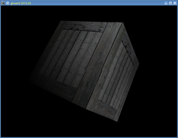

Hey Rene, thanks for the kind explanation. No hard feelings. I didn’t see your link because I thought it’s an advertisement. It’s the first time I am using this forum here, I am “coming” from the yahoo kicad-dev group, so the looks of this forum is new to me. Sorry for missing it. This is the output:

                              glmark2 Score: 756
As far as I can tell, every test “worked”. At least I could watch lots of transformation loops.
So, following your logic, this bug indeed seems to be one of KiCad -right?
More info: My laptop: Acer Aspire V Nitro VN7-571G-56BR. If I read the specs correctly, I am supposed to have a GeForce 940M.
Your OpenGL test is using the Intel graphics
