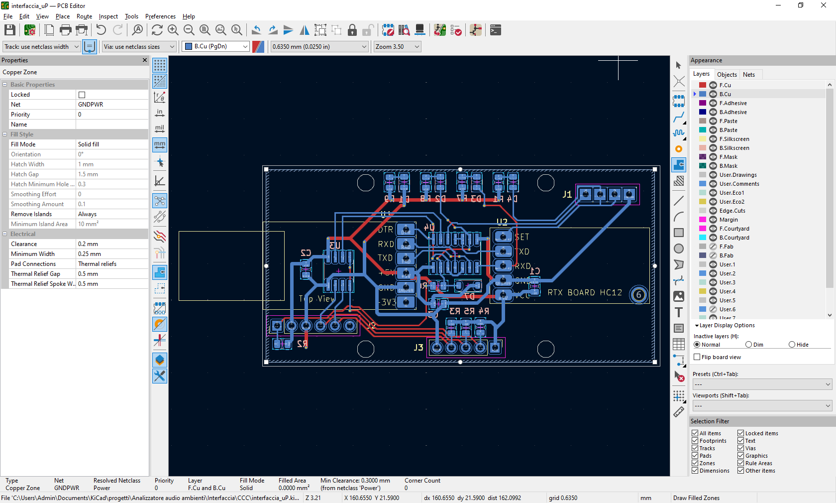

I have a quite dense small PCB, mixed TH and SMT. I need to fill with ground area.
I have done this procedure several other times with kicad 8, without problems.
Now with kicad9 i have this problem.
  1. I draw a fill area, double layer, top and bottom.
  2. I connect fill area to GND through right click / properties.
  3. I fill all filling areas (right click, / filling areas / fill all areas)
    Result: no filling area at all, I did try many ways, few components, empty board, small ground filled area placed over a single ground line, but nothing at all. No filling.
Any ideas? same schematic, in kicad 8 goes well. Once converted to 9, problems.
I have not tryed yet a complete redrawed schematic, but if this is the solution, it would be a bit annoying.
Probably I am doing something wrong.
Thanks.
Could it be the same issue as this topic, no edge cuts outline?
It look’s like, but I have the edge cuts. I try to post some images.

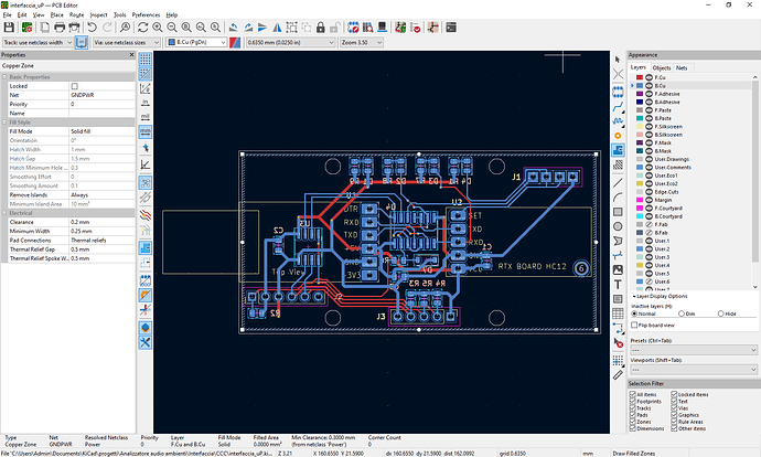

First image: beginning of manual routing. All parts there, cutting edges in white.
Second image: finished routing. I add fill area in bot sides. Setup is exactly the same used for many others in KiCad8.
Third image: the fill area is well closed. All the parts inside the cutting edge.
Fourth image: only the holes have been filled, with warning because insulated islands.
I am stacked at this point. With V8 I had the filling into the area included between rectangle and holes.
It seems that the rectangle has been ignoired at all, but it is there ang grouped with the holes.
But ungrouping gives same result.
If someone from kicad wants to investigate more in deep, i can provide the project file.

That was easy!
Why do you have circles as edge cuts?
I just removed them and draw a new edge cuts.
But maybe you have done it that way since 30 years and it is absolutely the better way. I don’t know, I’m using KiCad since abot 10 years.
It’s 30 years I draw the GND too.
About the circle, I do not know why there is a circle. In V8 version there is a circular cutting edge.
I check immediatly. Thanks.
Here it is!
Removed all GNDPWR traces and the 5V traces.
Assigned one plane to GNDPWR and the other one to 5V. Took only about 4 vias and about 5 connections.
I don’t know why you have used user1 and user2(?) I removed them and added a edgecuts. You’ll have to adjust that.
Fill area problem 2.zip (437.9 KB)
Circle cutting edges removed. I can fill
Added a circle cutting edge and again the problem appeairs.
But at this point is no longer a problem.
BTW, the circle cutting edge in V8 always warked so far and always had good PCB.
I will use the Hole symbol.
