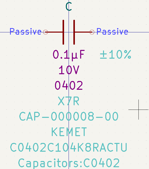

@craftyjon How do you set generic placeholder values on the R/C symbols for the kicad_dbl library to update those with whatā€™s in the database?
I skimmed through the doc and I donā€™t think that part is covered: Schematic Editor | master | English | Documentation | KiCad
Itā€™s not missingā€¦ these are provided as part of the default KiCad libs.
You donā€™t need to do so. You just configure the fields in the database config file.
Cool I didnā€™t know the default library had generic symbols.
How can I unbundle this mess though?
To get something clean like:
Also ${Capacitance} does not update with the Capacitance field, is that my setup missing something?
Place the symbol on a schematic instead of looking at it in the symbol editor. Using the symbol editor with a database library is not useful.
