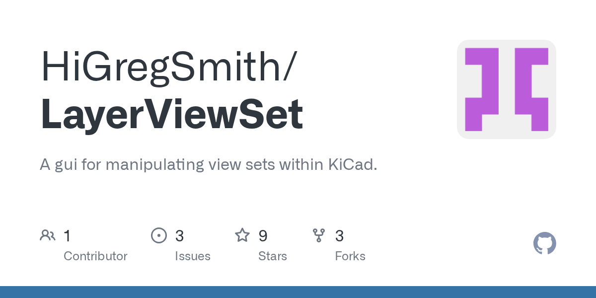

Check out LayerViewSet. Let me know if it works for you. It’s been tested in older nightlies and 4.0.6.

What’s that “LayerViewSet”? In a daily build I can find on Layer tab -> context menu -> “Show All Front Layers” etc. which should do the trick, but it doesn’t work well ATM - it selects/deselects the right layers but I have to e.g. go to Render tab and deselect Pads Front if I want to see only Back layers.
LayerViwSet is a plugin I wrote:
Ah! Sounds useful. But one of my pet peeves at the moment is that there is much potential in scripting but it’s not realized. There are several nice useful projects but few find them or even want to try them because it means downloading, saving, keeping up to date and being unsure if the nice script will work in the future. There should be a script downloading tool, a bit like web browser plugins.
