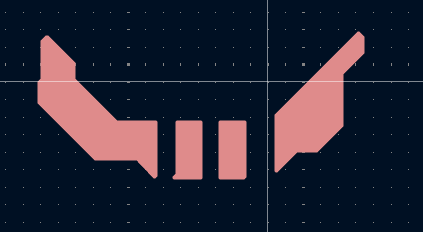

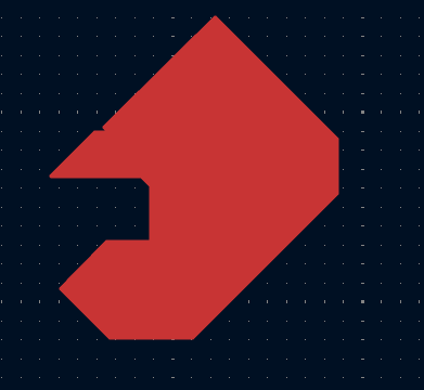

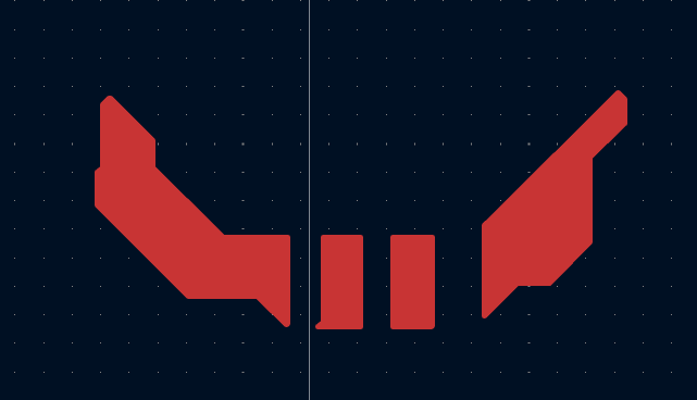

Finally, I managed to attempt to replicate your problem. See below. This is the result when using 9.0.3.
LH drawing = circle not yet turned to a polygon + the reverse E polygon.
Middle drawing = result of Shape Modification > Intersect Polygons after polygons filled. Looks good.
RH drawing is result after Save > Close > Reopen Kicad.
I agree with your findings. There is a bug. I am using Linux Mint.

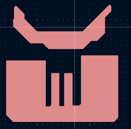

Shapes:
Intersection before save:
After saving, closing project and KiCad, reopened KiCad and project:
looks OK to me.
