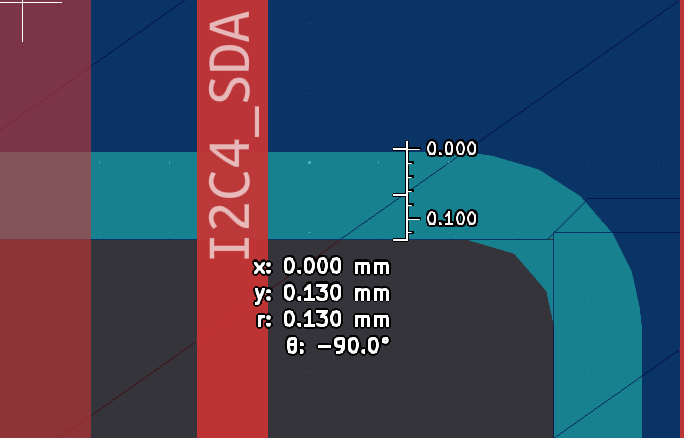

How to Set Clearance Between Copper Pours in KiCad 8?
Thanks for pointing that out.
Yes, I’ve set the netclass ‘P’ clearance to 0.12 mm, but I’m actually trying to achieve more than 0.1 mm clearance between the copper pours. The issue is that no matter what value I set, the clearance between zones ends up being either 0.06 mm or 0.07 mm—never what I specified.
In some parts of the board, it shows 0.06 mm, in others 0.07 mm/.08mm, which makes it really confusing. So even though the netclass appears correctly configured, the actual clearance when zones are filled doesn’t match the setting. That’s the core issue I’m trying to understand and resolve.
Also, when I run the DRC, no clearance violation is reported, even though the spacing is clearly below the value I set. That’s what makes this even more difficult to debug
The issue isn’t limited to just those two zones — I’m specifically facing this problem across all copper pours. No matter which zones I look at, the clearance ends up being around 0.06 mm or 0.07 mm, even though I’ve set a higher value in the netclass

No, that is not true. You’re running in circles because you are looking for the wrong dragon. KiCad does not suck the clearance of 60um out of it’s thumb (KiCad does not even have a thumb). As a logical deduction: Somewhere in your project, a clearance of 60um is defined, and apparently this overrules the settings you attempt to apply to the zones.
In the screenshot from your clearance report, there is a scrollbar on the right:
And it’s a short bar, so it looks like there are 6 to 8 more pages of text of rules that KiCad went though. One or more probably define that 60 clearance rule that overrules the others.
In the post where you wrote that, you had two screenshots. One was zones in VDD and 3V3. That shows that the constraint for netclass P is applied, 0.12 mm. But we can’t know if you have measured any clearances for those nets.
Then you show a test which resolves to 0.06 mm. The cause is of course that “condition not satisfied” for every rule.
You should probably show the whole custom rule set, it’s easy to get some rule wrong. Then you have to choose two items which we all can recognize and talk only about them; otherwise we will be confused by screenshots which aren’t related to each other.

To me it looks clear where the problem is. The explanation can be found if you combine the generic explanation of the rule syntax in PCB Editor | 9.0 | English | Documentation | KiCad, and insideCourtyard().
EDIT: or actually just insideCourtyard().
LORAWAN_GATEWAY.zip (2.6 MB)
Yes, the insideCourtyard rules are the reason. Here’s your rule set modified, you can try re-filling zones with this:

Note also that you have “constraint clearance (min 0.06mm)” while the minimum clearance in the Constraints setup is 0.07. The Constraints has absolute minimum values which must not be violated (minimum manufacturer accepted values). However, I don’t understand why the algorithms don’t obey the minimum clearance Constraint and why DRC check doesn’t catch it as an error. For example the front GND zone around U12 fills to 0.06 mm against tracks.
Thanks, it worked. I had to uncheck the fill option before running DRC. In the future, is there another way to set clearance directly on a footprint? What methods do designers commonly use?
