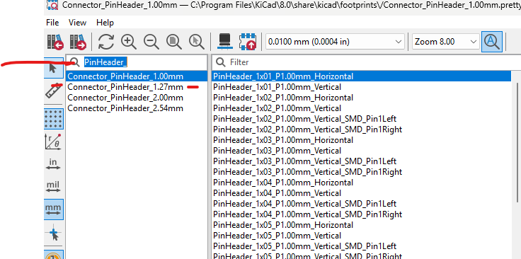

Silly question: are you ACTUALLY loading the relevant library? Ages ago I de-selected a LOAD of non-relevant libraries to make things load a lot quicker, maybe you did that too?
A search box comes up when I click “Place Symbols” in the schematic toolbar. The closest it gets to “PinHeader_” is some 2.54mm footprints (see image below). There are no 1.27mm footprints even though I can see the files in /usr/share/kicad.
All of the boxes are checked in Preferences → Manage Symbol Libraries… Though I noticed that it only seems to find .kicad_sym files, while PinHeader_ is .kicad_mod files. And it’s not finding the /usr/share/kicad/symbols/Samtec_FTSH.kicad_sym file that I installed. It is showing lots of files relative to a non-existent (blank) $(KICAD7_SYMBOL_DIR) path variable. $(KICAD9_SYMBOL_DIR) points to /usr/share/kicad/symbols, but it’s not picking anything up from that directory (if you believe the list that it displays).

Footprint libraries have to be added to the fp-lib-table file in a very similar way that symbols have to be in a library and the libraries have to be added to the sym-lib-table file. And the footprint link in the symbol does have to have both the correct library name and footprint name.
Aha! The file that I downloaded from ultralibrarian was missing the library name in the footprint link. Looking at some other examples, it needs to be added to the “Footprint” property and must precede the footprint name with a colon. In other words:
