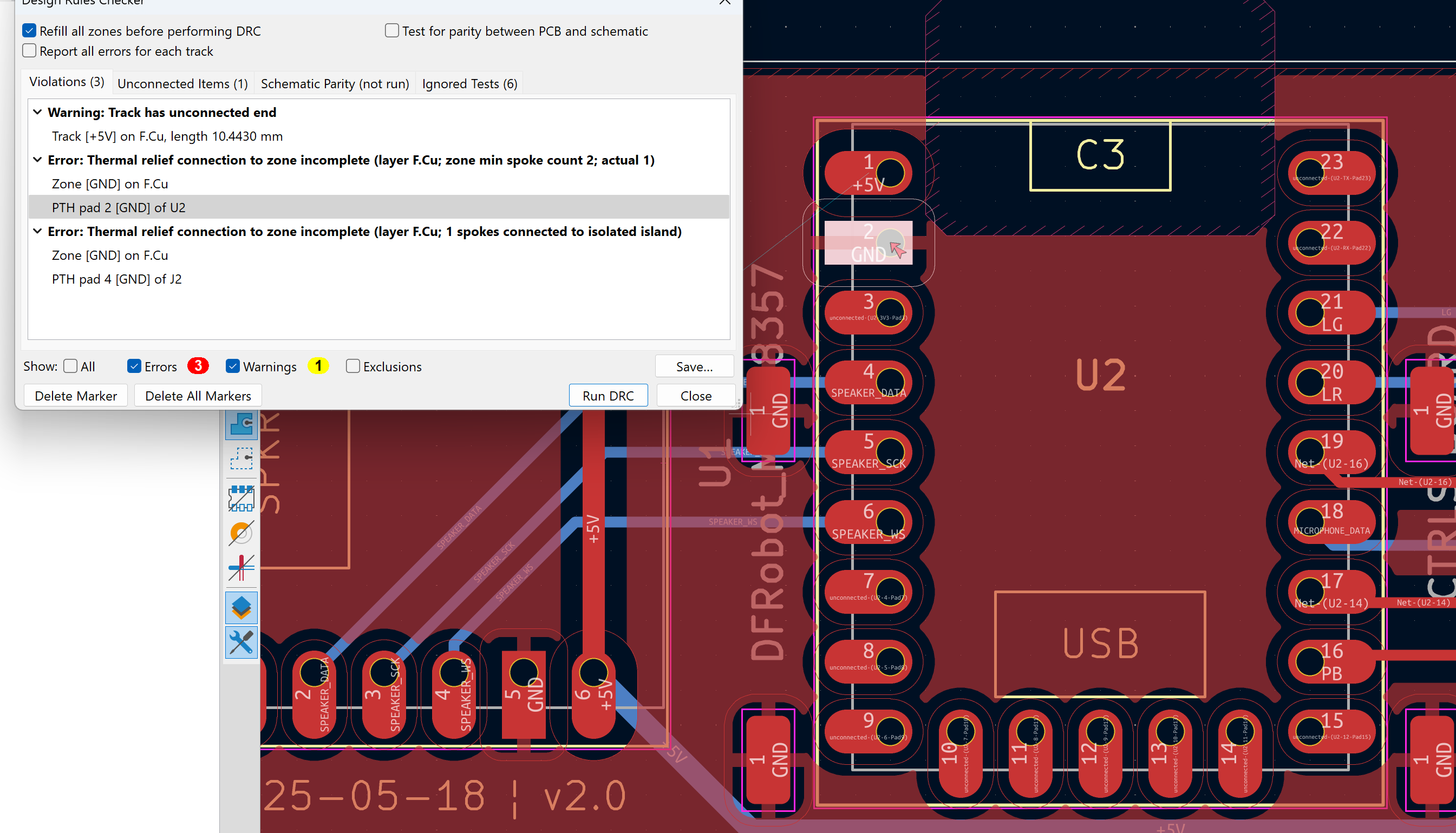

How to handle isolated island in a ground plane
technically i don’t see one.
How can I best approach this?
use vias and connect to bottom gnd, redesign the footprint with smaller pads, or use a pcb technology that enables you to connect between pads ($$).
Choice is yours.
btw, if you are using a castellated pad module and you want to mount it ‘smd style’ i don’t think placing plated holes on the pad is a good strategy.
Which is the isolated island? The one in the middle? If so - it’s connected via pin 2.
Either way I’d add some vias if you have GND zones underneath.
And you have 5V pin 1 not connected.
If you do not want the big ‘island’ under the foot print, you can add a ‘no-copper-zone’ there.
I feel daft not to mention what the isolated island is. Yes, it’s the big zone beneath the ESP32. May I ask why you say you’re not seeing the isolated island? The one below the ESP32 connects to the outer ground plane only through the 2 GND pin. I assumed that this is the reason DRC was complaining. DRC errors:
Now that I’m reading the errors again, I see that it’s not complaining about the isolated ground plane. It’s complaining about a minimum number of spokes count. Sorry for this. I’ve been trying different things and it toggles between these two errors. The isolated island error is there, but for a different place on the board:

I must say that I don’t understand the difference. For both I see a ground pad connected in two places, one to the (lets say) outer ground plane and one to an isolated one.
as greg_m pointed out, the copper area is indeed connected (with 1 spoke per side) to gnd.
The DRC is complaining that just 1 of the minimum 2 spokes required per side is possible to draw.

I’ve made a few changes. Ground plane is at both sides now, which allows me to use vias to connect up some islands. I’m designing two boards, and on the other board I could fix one min spokes DRC error by changing the angle of the spokes to 45 degrees (was in the linked post; thank you!). I fixed a few other ones by adding GND tracks. I did decide to remove the island below the ESP32. I don’t understand the trade offs to make a decision about e.g. clearance around the pads, and I did want to keep the THT holes for now.

I agree with you. Both situations look the same.
Which version do you use? If V9 than you should expect it still being buggy.
I see one difference that can, may be explain DRC.
One error says that there is only one spoke while two are needed. The question is why KiCad sees one while we see two. It is possible that when this will be solved than DRC will report another Error - the same like in second case.
In second case I understand error as saying you have to have 2 spoke connections and you have two, but one connects to copper area that has no other connection so if not this one connection it will be isolated island. Such connection really not gives you two spoke connections to general GND zone.
I supposed that if pad has two spoke connections from which one goes to island DRC will be satisfied. I am surprised it is not. May be it is something new in DRC.

I’m using 9, so that may be the cause. I ended up switching the pins around to get rid of the island on the second print screen. I’m pretty happy with what I’ve ended up with.
