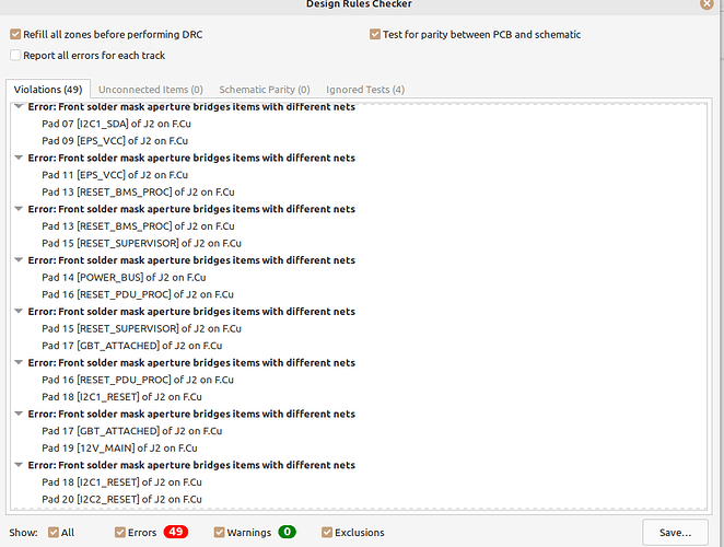

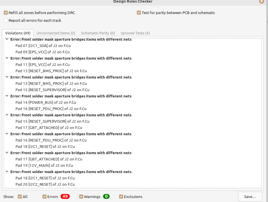

How do I fix solder mask aperture bridges items with different nets?
I got an Error
Error: Front solder mask aperture bridges items with different nets
The connector where this is occurring has pads with 2 mm of space between the pads.
The soldermask expansion is 0. In the Board Setup and in the Clearance Overrides and Settings.
What am I missing?

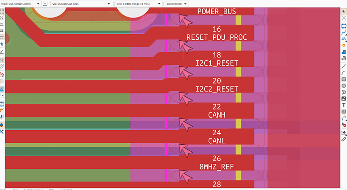

Posting a screenshot may help.
I am not sure how the screen shots will help, but here they are.

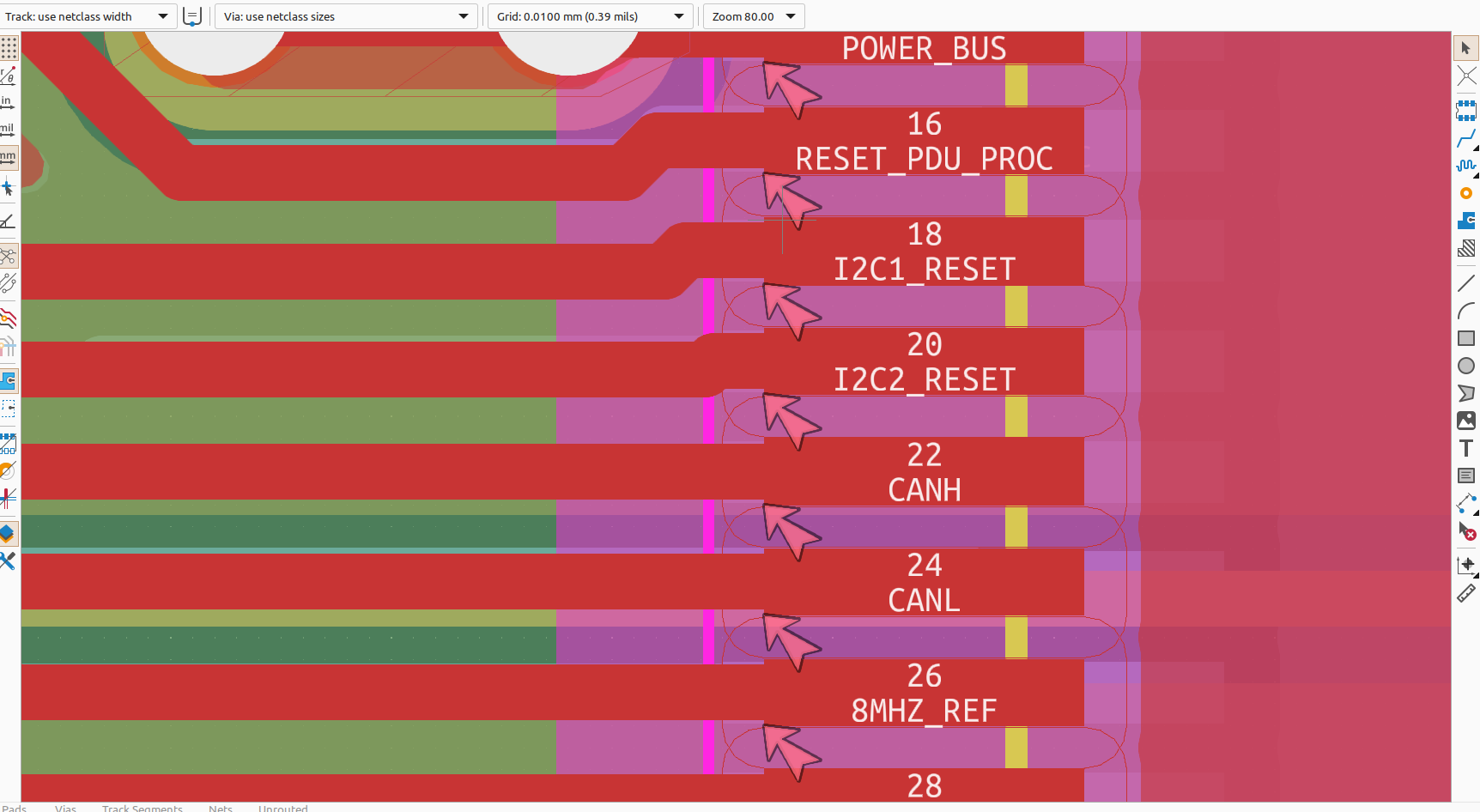

Looks to me like the pads on that device were drawn with a huge soldermask expansion.
Edit the footprint and see if there is a soldermask clearance override being set. If so, remove it, or modify it to be smaller.
I think I found it. But I do not understand it.
The part was from SAMTEC QTH-030-02-L-D-A
In the part, for each pad, under pad properties they had under Clearance Override and Settings a solder mask expansion of 0.102 mm. I changed it to 0.1 mm and it did not fix the problem.
I changed it to 0.05 mm and that fixed the problem.
I am not sure why they had an override at all. The pins are on 0.5 mm centers. With pins that close I would have wanted solder mask between pins to help prevent solder bridging.
