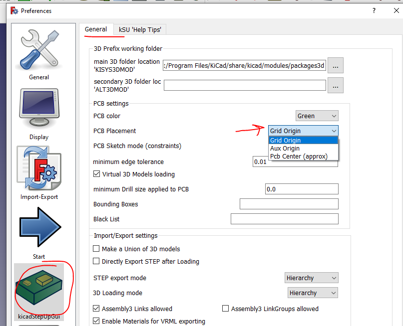

Hello @BlackCoffee, thanks for demonstration, from Kicad side I’ve defined, on both board project, the same grid 0.254mm, same “grid origin” and Layer alignment target :
When looking on bottom line X/Y position is 46 - 68 from one PCB and 47 - 84 on the other. Then importing .step files or pcb with add-on StepUp boards are not aligned on FreeCad :
Do I loose something ?
By default StepUp places the PCB on the “Grid Origin” not on the “Auxiliary origin”, you can do change the StepUp setting to “Aux Origin” or put your grid origin in the same spot as your “Auxiliary grid origin”
One is the gray cross and the other one is the red circle:
the layer aligment target is not necessary in your case.
Hope this helps.

In FreeCAD you can vizualise where your origin is if you select: “View->Toggle axis cross”
Example, two different origins:
My mistake in assuming (hoping) that when I posted using the Aux Origin and included image of that setting in FreeCad, several posts above, users would clue-in that if they prefer Grid Origin, they could explore the pull-down in FreeCad’s panel… and use Grid Origin… Silly me…
