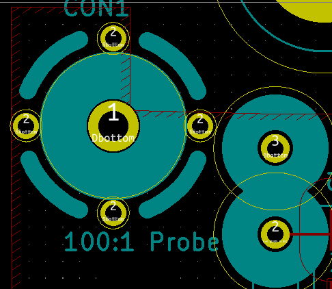

Adding a slot in the PCB where the volts/cm is high really helps.
Another option is to add silkscreen over the area. Some time I cover the entire area and some times I make many thin lines to make the surface bumpy. This causes the electrons to travel further to get from point A to B. I tested this with my HV power supply and it works better.
In the picture there are three spots with 1500 volts. The silkscreen also helps me remember to keep traces out of that area.
The concern with this is the typical thickness of a silkscreen print is 15um, and thus 5 such printing patterns only increases the creepage distance by 0.15mm, not that significant. Now if thicker silk was used sure, but not bog standard fab house stuff
Silkscreen is not designed for electric isolation, and can not be relied upon for such. Silkscreen is often printed with a dot matrix printer, and there may be small holes or other artifacts that prevent a decent form of isolation.
If you want extra isolation, add a decent layer of conformal coating, or use some potting compound.
The cheapest and easiest I can think of is a few mm of hot glue.
yup, slots, conformal coating or some bonded barrier (yup hot-glue would do, although I would use some former and bond it with DP-760 but the same principal).
As I always tell my engineers, over-current is a time thing, but over-voltage? do not pass go, go straight to avalaunch. It is the one thing when pushed by mechanical to “make things smaller” I do not budge…
I hear what you say. I did test with a “hi pot tester” and a 10kV power supply.
A bear PCB with no solder mask performs poorly. Just adding solder mask increases the breakdown voltage far more than what 15um would account for. Adding silk screen increases the breakdown again.
Back in the “through hole” days I put silk screen under all resistors with high voltage on them. Electrons will break through the side of resistors and head for the nearest copper. I don’t think adding micro meters made the difference. It was adding another layer of insulation. Those resistors only had paint for insulation. I did not measure but adding a layer of “paint” to the PCB probably doubled the break down voltage.
Adding that silk screen is likely to have some effect, but that is not the point here.
It may help for hobby purposes, but for production you can not guarantee that each and every PCB will have it’s isolation boosted effective enough with a bit of silk screen, and therefore it can not be relied upon. For a reliable process, you need [Edit: A suitable] conformal coating.
And with a specified / controlled breakdown voltage characteristic. I was in Automotive and was of the belief that if you made a million of anything you will find or get bit by anything that is not controlled. And often those that are controlled.
Factories hate conformal coating. Cost money and the repair department really hates it.
For high end test equipment we coat the boards. (some times)
For TVs and Monitors we never did. If the board is vertical condensation is not a problem. Horizontal mounted boards can pool water and spark over. We used slots, and/or silkscreen. I have had a number of call from Japan, Korea, Singapore where they removed the silkscreen in the HV areas because they did not know.
No argument, the coating is better. The silks cost me nothing, and the repair department does not threaten strike. lol
