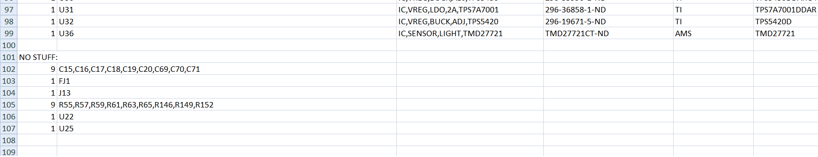

You can choose to include or exclude DNPs. I choose to include them and sort them to the very bottom of the BOM then manually edit the BOM to include only the reference designators in a separate section called Do Not Stuff:
FWIW, my CM wants to see all the components in both the BOM and the PnP files and they reconcile on job setup. It’s flushed out an error on my part more than once with an email about a footprint with a refdes but not called out on the BOM as either a stuff or nostuff. They recon that’s an error and they’re usually right.

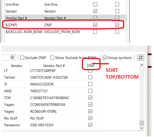

I have found a workable solution. There is a “Exclude all footprints with the Do Not Populate flag set” flag when generating the position file. If I check “Exclude from BOM” on all the DNP parts and check the other flag when generating the position file, it does what I want. That flag is not sticky like most other settings, though. But if I mess up something, JLCPCB will give me an error, so I have a double-check.

KiCad can sort DNPs to the bottom (or top) of the BOM for you:
Yeah, like I said, I would like it if the DNP flag could be put into the position file. I do post-processing, mostly automated and if I could have all the DNPs at the beginning or end, that would work. How do you do that? I don’t see an option.

Ah, if you generate the BOM from the schematic, it will put the DNP in there. If you generate it from “Fabrication Outputs” in the PCB editor, it will not. Ok, I’m happy with that.
