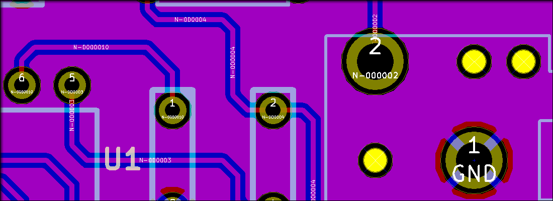

I’ve read that copper going over the edge or over drill holes will get them plated for the hard-to-communicate-with chinese fabs (*).
This naturally implies that the CAM system processes both the gerber and drill file together at some point.
*) found my source: http://electronics.stackexchange.com/questions/78094/how-to-specify-castellations-in-gerber-files
… most board fabs will plate any copper that is over or directly touches
the edge of a hole or routed feature. So a ‘standard’ way of defining
this is just to have copper over the edges of your castellations. This
is how vias and plated through holes work - and conversely, this is how
non-plated holes work as well (you just pull back the copper a little
bit from the hole).
So to distinguish between PTH and NPTH in a single NC drill file the CAM system needs the copper layers.

It might not be a problem much longer! We’re currently putting in a fix to automatically combine the drill files, so if that works out well then it won’t matter if you have two drill files. For the immediate future, you’d need to merge the files into a single drill file with both plated and non-plated holes. We use GerbV for this, which is pretty quick and easy. If you’d like, you can send the files over and I can help out as well.
Also keep an eye on the Drill File support pages, since I’ll be updating those to show the proper state of the server as soon as our fix goes live. Could be as soon as tomorrow!
Might be time to check up on that with OSH park and not demand work-around-the-spec features from KiCAD?
Don’t see any updates on that page though…
@Joan_Sparky
GerbV version 2.61 (the latest stable) does not support correctly oval drill, so if you merge PTH and NPTH drill files with that tool, you will have a wrong result and you will produce a bad board… and I wouldn’t trust the buggy GerbV beta version (which is not been updated since an year)
I know that kicad is acting in the right way, but at the same time I would appreciate the option to merge the files internally, only when needed to give those files to the ‘blamed’ fabs :slight_smile:
thanks to @Joan_Sparky for pointing out the OSHPark support
"We support both vias (plated holes) and unplated holes. The fab uses
the presence of copper underneath the drill hit to determine plating.
Copper  underneath the drill indicates a via/plated hole, no copper
indicates an unplated hole. "
