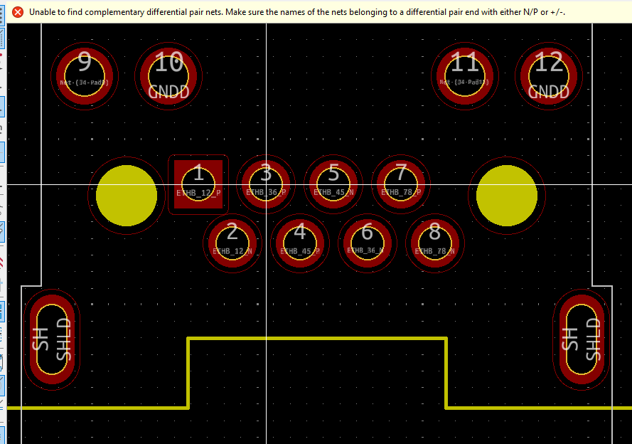

The 3/6 pin pair is the obvious outlier and causes the termination to be farther apart than the other pairs.

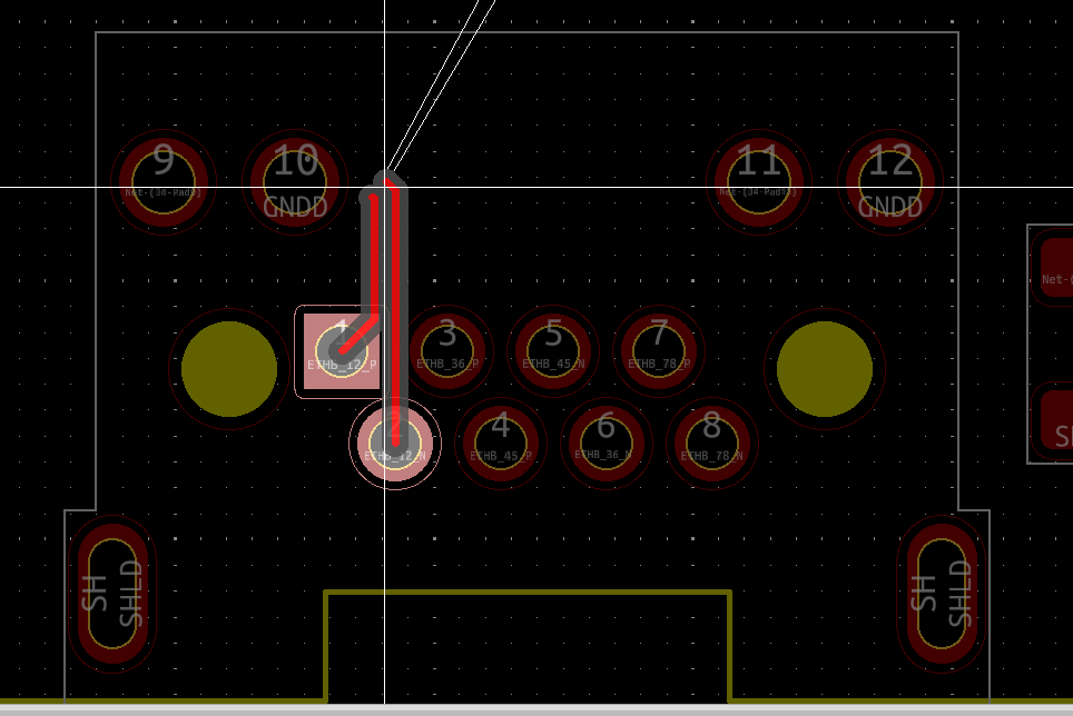

Here I am successfully starting diff pair routing on pair 1/2:
And failing when trying to start 3/6:
I suspect the issue is that the starting point of the pairs are too far apart and so the diff pair router cannot possibly satisfy the routing requirements, but I can’t find where in the settings I can adjust this and am not even allowed to begin routing due to the error.
How can I relax the starting point requirement?

For most of your net names, the underscore is below the center of the pad, but for ETHB_36_N the center of the pad is in between the underscore and the 3. This implies an extra character in the net name. Maybe this net has a trailing space in it’s name? For some (incomprehensible to me) reason KiCad accepts trailing spaces in net names, and this is a different net then without the trailing space.
Ugh this was it. Thanks for reminding me to check. There was somehow a space added to the end of ETHB_36_N.
