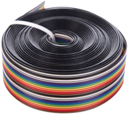

But what has that to do with long wiers?
Because those bords hole purpose is to connect inputs and outputs to flightsimulator or cnc.
How would you do that if not with wiers?
If I for example connect a switch to ground and a digital input, with 4 meter kabel. Ho would that be harmful in any way? Even if I Short the cabel to ground. I can’t see that long cabel would cause any problems with induction.
So I don’t see any problem wit 1 meter cabel or 5 meter cabel. The signal will come threw.

An answer like this would have bin more helpful:
The length of the cable will depend on the type of signal transmitted such as whether it is analogue or digital, its frequency, low/high impedance of the signal source, the type of cable used and so on. For I²C, the length is better to be within 3 meters. The length can be made as long as 300 meters.
With a 22AWG cable length of 50 meters and a 100mA current, the voltage drop would be around 1 V. The capacitance of any cable will affect the rise and fall times of the signals. That can affect the measured duration of the pulse received from the sensor. As for the analogue signals, it may be important to add a capacitor to decouple the power to the sensor at its terminals. But, really I wouldn’t add capacitor alone to the sensor line. I will also add a resistor before the filter capacitor. In the case of an SPST switch, following this way you can practically use a 100 meter shielded cable (like CAT 5e cables or cables that are used for phone lines).
And back to the qusetion, will a digital input be affected by a 5 meter cable, most likely not.
Tell me a situation when a digital signal would have problems on a five meter cable? The probable length would certainly not be more than 2 meters.
