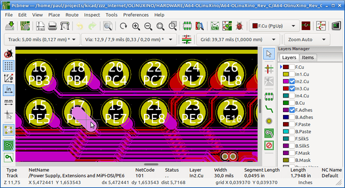

Teardrops are also useful for thin tracks (such as 6mil) connected to THT connectors. Just think PC104 here. Mating and un-mating such connectors can put enough stress in the PCB for thin tracks to the THT holes to break, and Teardrops prevent this because they distribute the stress on the track.
Here a screenshot of the A64-Olinuxino in which fat tracks ends are used to approximate teardrops for this reason:

Just make the trace segment going to the connector pins thicker than the rest of the trace. It’s literally the same thing.
