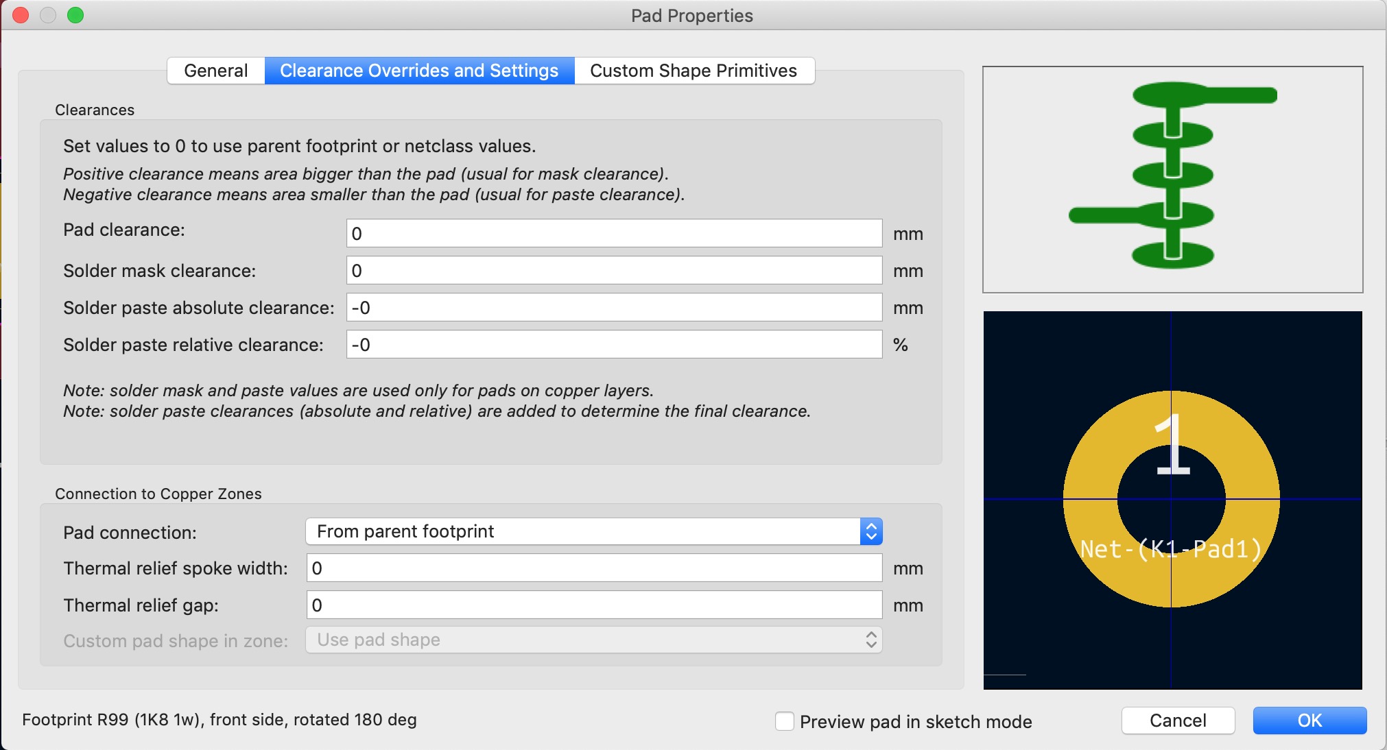

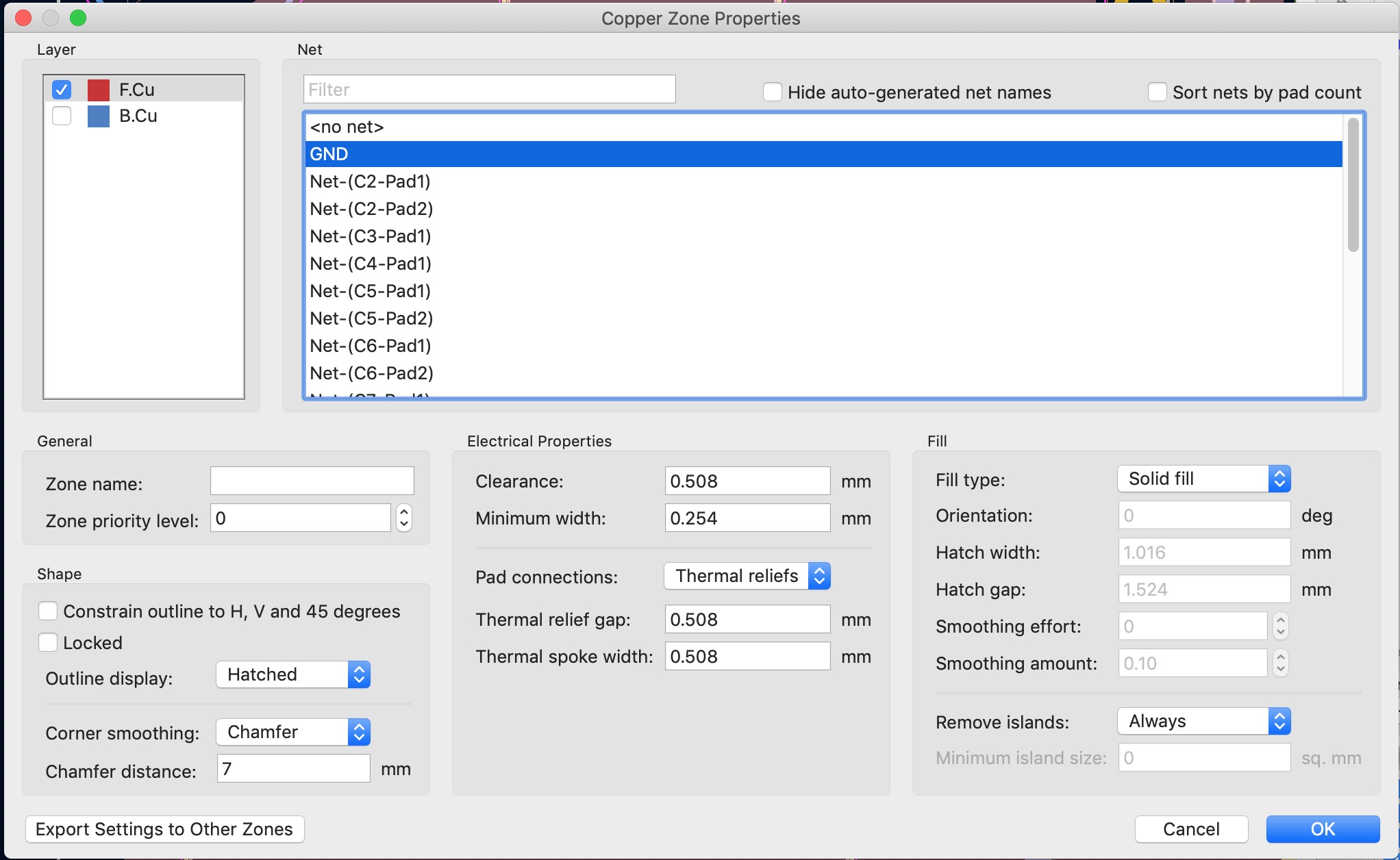

Another point : when I edit the cooper zone the dialog box tells me that all GND pads have a thermal relief (see pict please) but when I edit them one by one they are in the “from parent footprint” mode…

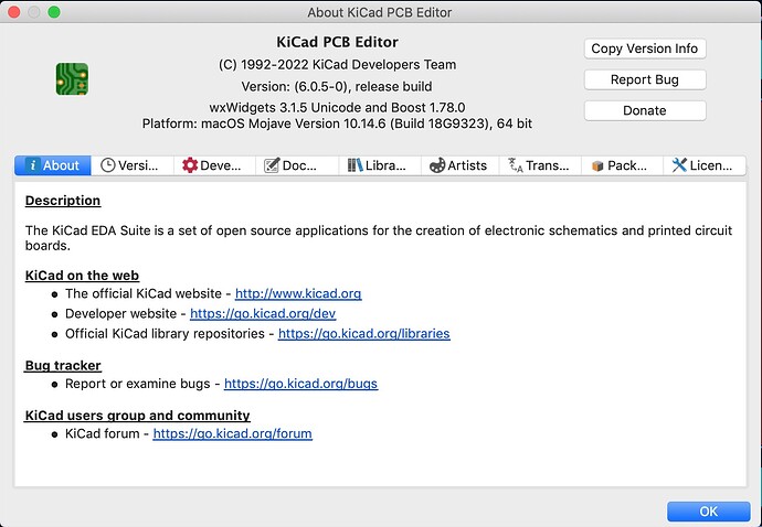

It will help someone answer if they know if you are using version 5.x.y or 8.a.b or 9.d.e or 7.r.s etc . . .
Can you paste your full version info here please, you can get it from KiCad > Help > About KiCad > Copy Version Info

Each zone needs to be created independently. You have at least two zones: one for F.Cu and one for B.Cu.
As you show in your above illustration, setting Pad Connections to “Thermal reliefs” will result in your Gnd. zone connecting all the pads on the Gnd. net with Thermal reliefs.
Individual Pads can be set with “Thermal reliefs” in the Pad properties.
I’m not sure of the meaning of the terminology “From parent footprint”, maybe someone will enlighten us.
Here is my Kicad version

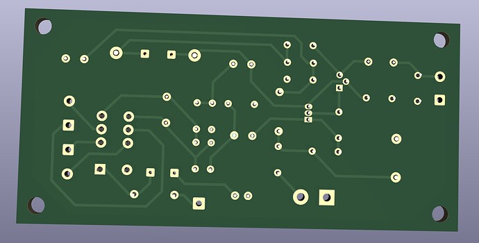

Here is a screen capture of the B.Cu side of my board. One can see that tracks are quite spaced.
The power concerned here is +48v@15mA maximum. All nets are set to 0.5mm (voltage & signal). GND is connected straight to the cooper zone and all GND from the diff. boards will be connected together to one and only point (and to chassis).
I should have said that it’s about a mic preamp…

Copper zone properties > Pad connections offer four alternatives. ie. Solid, Thermal relief, Relief for PTH & None.
I have no idea which was default.
Yes, if the Pad connections is set to Thermal relief.

From what I see in the dialog box, only cooper zone seems to be concerned by thermal relief pads…
The other pads read : “from parent footprint” which means (I guess) that it depends on the component concerned

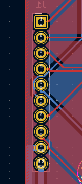

Sure you can. The fill will just avoid the pads that are not in the same net as the fill. Here’s a section showing a connector on a board of mine.
Pin 9 is GND and you can see the thermal relief spokes. Pin 10 is VCC and the F and B fills avoid the track leading to it.

When designing footprint:
  • for each pad you can individually decide if it has specific connection to zone or it will use the way specified for the whole footprint.
  • for footprint itself you can specify how it is (means all its pads except those having individual specification) connected to zone or if it uses zone settings.
I think that most KiCad footprints not define thermal relief making it being taken from zone setting so you need not to do anything else than setting thermal relief connection for zone and you will have all pads connected to zone as you want.

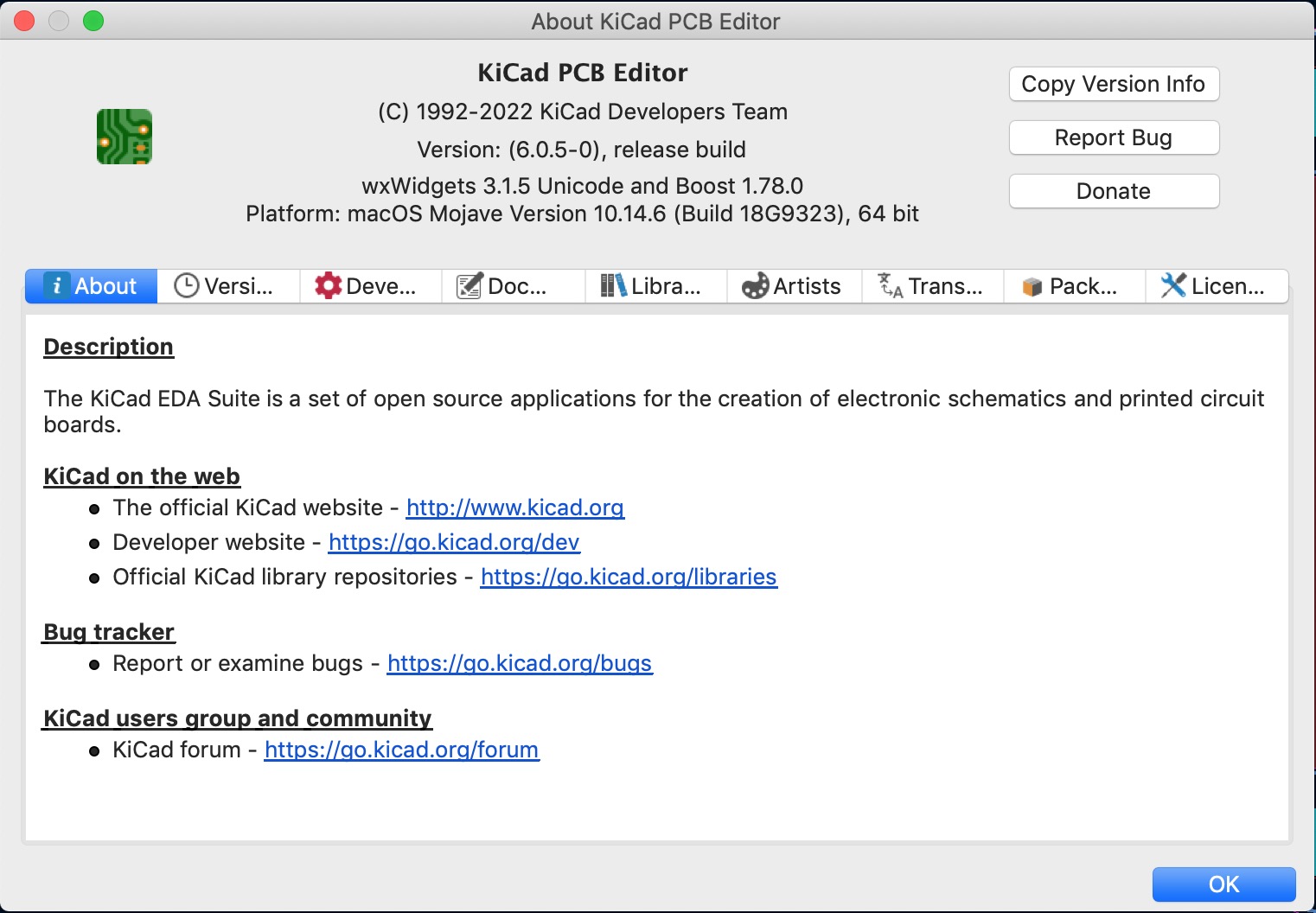

By the way - why you use V6.
People use V5 because since V6 Win10 is required. But there is no such difference between V6, V7 and V8.

I use version 6 because I’m on MacBook Pro / OS 10.14.06, not on Windows.
