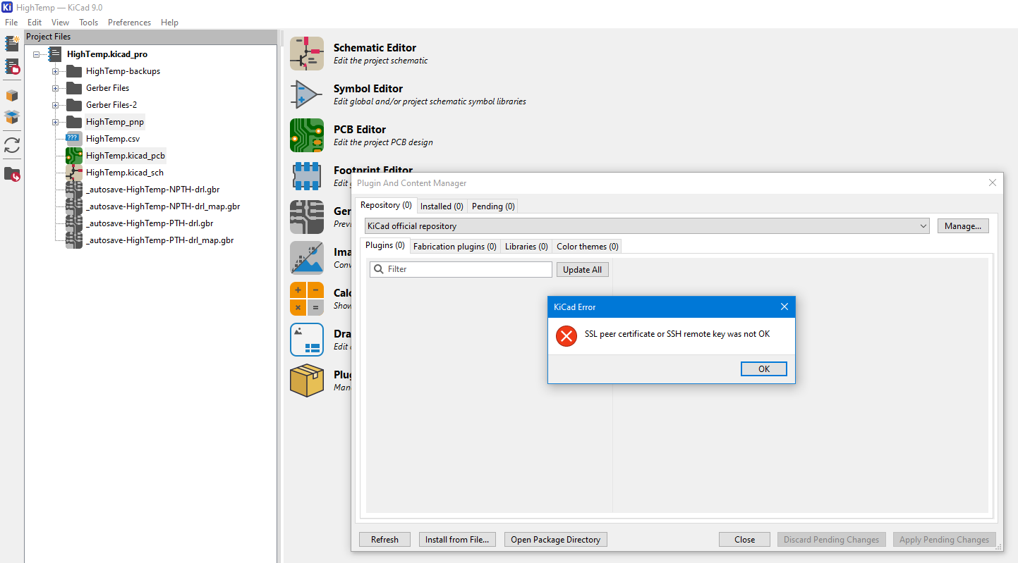

when i click onto my Pluins (Kicad plugins), I get this error: “SSL Peer Certificate or SSH remote key was not ok”. Any idea why I am unable to activate plugin ? Thanks

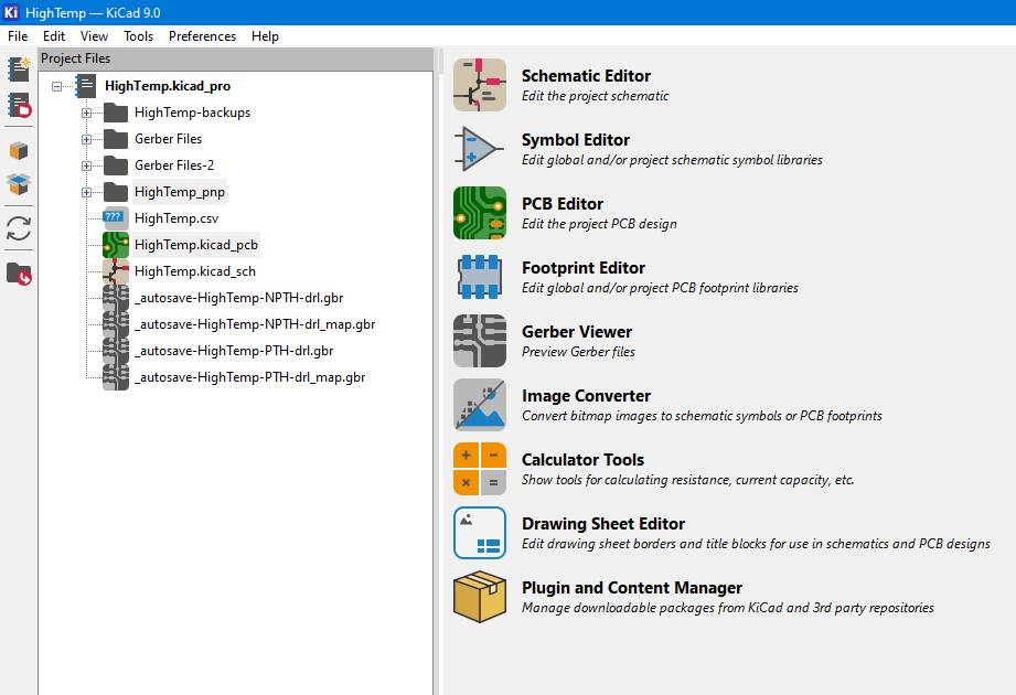

Hi, I do not get any far. Once I click on the “Plugin and Content Manager” icon shown in the picture. I get this error message (bottom picture). Thanks
I’m guessing the same thing is happening on your network as described here, and I’m sure your network administrator can help.
P.S. Maybe an OS update can fix it.

Thanks for your reply. Sorry for my reply back. I did exactly what you prescribed and the commands were successful. However, this did not change any thing.
What is your KiCad version and OS details?
I see your IP address is in California, so this is very odd. Are you using a VPN?
