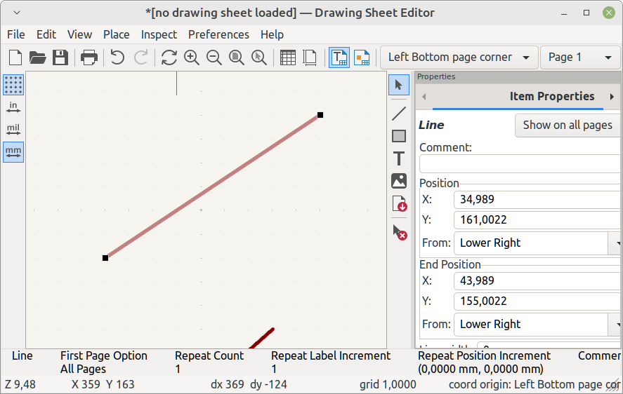

I also see something like that in the drawing sheet editor in KiCad V8.0.9. There seems to be a fixed offset when attempting to work on a grid resolution of whole millimeters. I wonder if those are all related. More in the thread below.

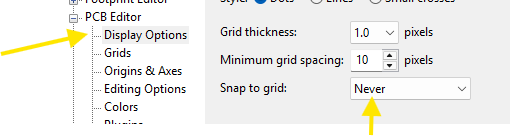

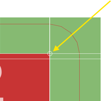

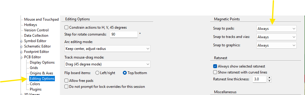

Constrain to H V . . is off
Snap to grid . . . is off
Snap to Pads, Tracks & Vias, Graphics - Always
So now I’m assuming I can snap to the centre of pads without the grid getting in my way . . . and yes I can if I want to place a track, that works just fine.
Measuring is a whole other matter . . . I cannot get the Measure Tool to snap to what it suggests it is going to snap to.

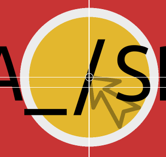

The circle suggests to me that the Tool has found a snap point here . . .

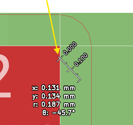

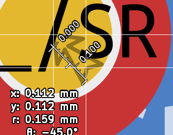

When I click I get this . . .
The tool took a position not at the snap point . . .

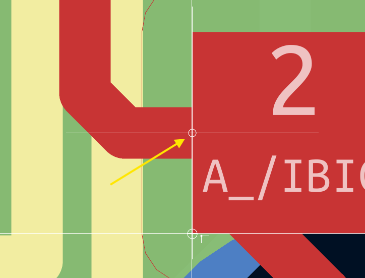

Also, what is this thing ?
I have what looks like 2 snap points . . . the lower one is the live one.
The “thing” the yellow arrow is pointing at is a target showing the X axis centreline of the pad. Depending on how you approach the pad, sometimes there is a Y centreline axis instead of the X centreline.
Unfortunately, using the measuring tool, to or from a pad centre, will only give you either one or the other centreline instead of the pad centre, which is totally useless.
