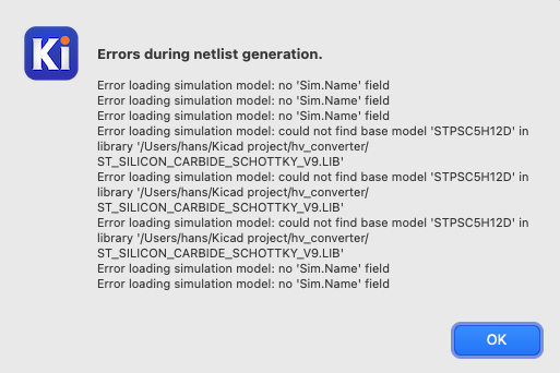

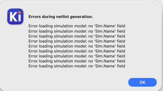

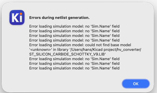

The error messages I receive are the following:

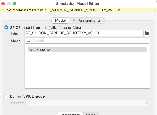

I also noted is that the model is not found while the model number is clearly in the the .LIB file.
Also in the Pin Assignments Model Pin shows Not Connected.
Can anyone point me to what’s wrong with this?

This seems to be a bug in KiCad, macOS. I can reproduce the issue on KiCad 9.0.6. However, on MS Windows 11, with KiCad 9.0.6, the simulation is o.k.
I have provided a bug report at macOS demo simulation with (external) model library fails (#22266) · Issues · KiCad / KiCad Source Code / kicad · GitLab
