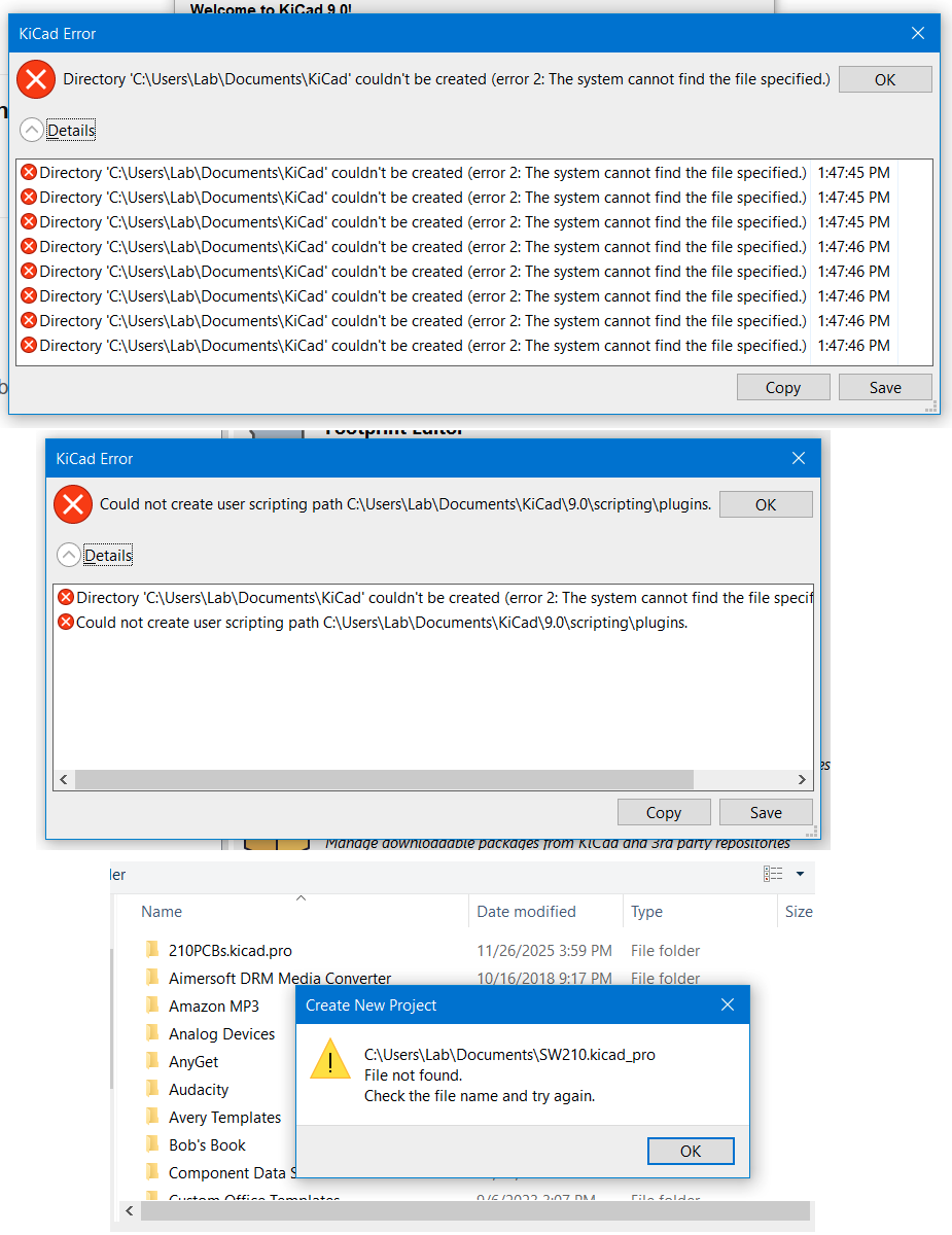

Just introduced to KiCAD, no experience using it yet because of installation errors. I’ve downloaded it a couple of times, from two different servers, but during installation I get a raft of error messages about the installer not being able to create a file, because “the file can’t be found.” It’s as though the installer is looking for folders created previous to the installation process. Once the (incomplete) installation finishes, neither the Schematic or PCB Layout workspaces will open. I click and nothing happens. The Gerber viewer will open, and looks like a really good one, but I can’t start a board design. I must be doing something wrong, or my computer senses a threat and is refusing certain instructions, but no idea of what to look for.

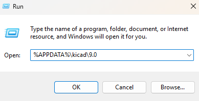

Honestly this sounds like corrupted settings in %APPDATA%\kicad\9.0, just nuke that folder and try again

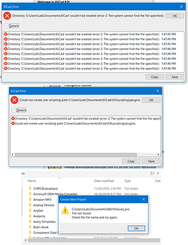

Thanks, davidsrsb. The first couple of times I tried to install, I was acting as a normal user. Seems to have made no difference. Here are the error messages I get toward the end of the installation cycle.
Not sure where to go from here. I do have another computer running Windows 10, and may try installing it there to see if I get similar results. Really appreciative of any help or tips from users; I’d really like to get this program running.

To get to the %APPDATA%\kicad\9.0 folder you can go into File Manager and navigate through:
C: → users → lab → appdata → local → KiCad → 9.0
I also have a folder:
C: → users → lab → appdata → Roaming → kicad → 9.0
If you can’t see the appdata folder once you get into the “lab” folder then, under View on the menu, come down to “Show” and tick “Hidden Items”.
Hope this helps!
Just paste %APPDATA%\kicad\9.0 into the file explorer address bar:
Or press Win+R and paste it into the Run box:
Uninstalling KiCad does not remove this user settings folder.
Can you run cmd and execute (you can paste to the command prompt using Ctrl+V):
mkdir C:\Users\Lab\Documents\KiCad
does that create the KiCad directory in C:\Users\Lab\Documents successfully?
