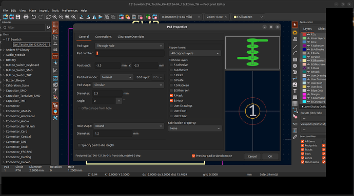

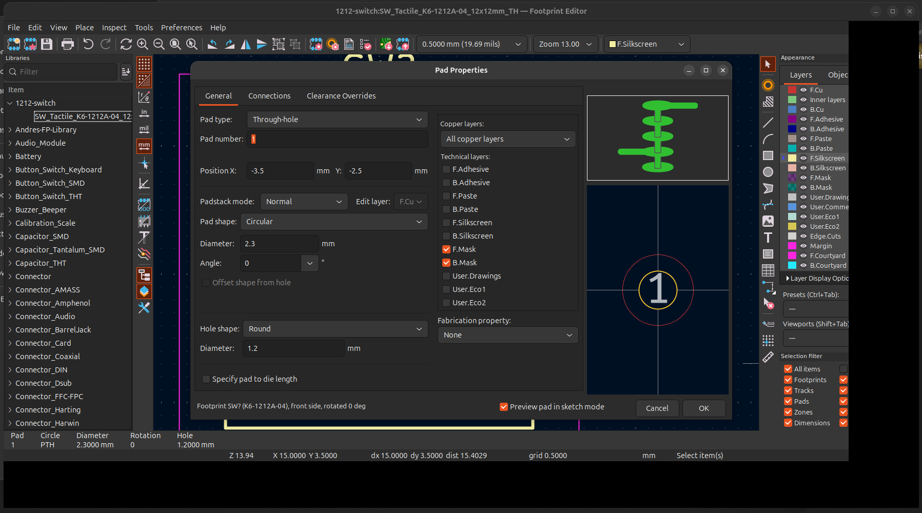

Ubuntu 25.10 / Wayland / KiCad 9.0.5
There are graphical issues.
1: please notice how resizing the window does not resize the contents.
2: I cannot click/edit any of the numeric values of the pad
I have also tried to use : flatpak run --env=GDK_BACKEND=x11 org.kicad.KiCad to run it, the issues vary, not always reproducible at first time, but they are there.

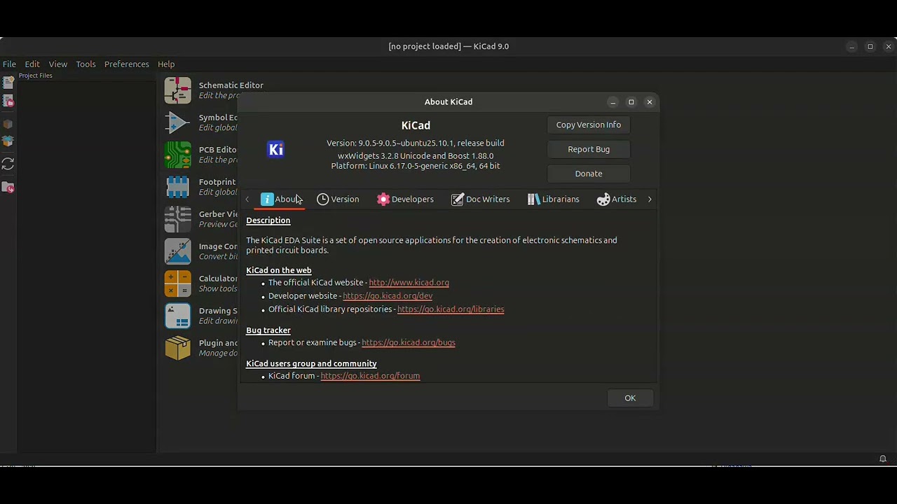

Please note this super-strange behaviour:
I can open and close the About window, or just interact with it - but at some point (0:57) in this video, you can see all tabs unresponsive and ā€œdisabledā€ they are not responding to mouseover, and do ot respond to clicks - but then I move mouse down to the text area, and scroll! - then the last clicked tab may work.
I do not longer believe this is related to the X11 variable.

i have investigated this further and this is a wxWidgets issue in the wxAui part. If you install wxWidgets 3.28 and build an AUI example, i.e. as from the website below, it shows the exat same issue. A basline wxWidgets app without AUI doesnt seem to have the problem
I now see that PrusaSlicer ā€˜s Preferences menu has the same issue. For all other applications I tried, this works fine. It could be that this is something that KiCad and PrusaSlicer does something differently that triggers this bug. (not necessarily that the bug is in those two applications)
This is liked to wxAui. Apps that don’t use wxAui don’t show the issue
