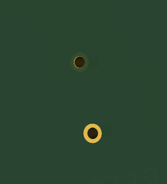

When I create a through-hole circular pad in a footprint, the copper ring on the top side is covered by solder paste (I can confirm this by turning the solder paste off in 3D view) and the ring on the bottom side is not visible. I suspect that it is there, but covered by solder mask.
What I expect is a TH pad with a blank copper ring on both sides. What am I doing wrong?
The upper pad is the (bad) one I created using the footprint editor. The lower pad is one I copied from an existing footprint of a pinheader.

So you created a SMD pad (which has a default solder paste layer) and then change the shape to a through hole pad . . . and then expect it not to have solder paste ? why would you expect that ?
If you want a through hole pad, create a through hole pad.

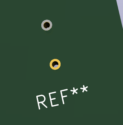

Meanwhile I found the solution to my problem. Once the pad is on the PCB change it to the desired pad type (in my case a circular TH pad), right-click on the pad and apply the ‘default properties.
Now the pad looks like it should be: copper exposed on both sides of the PCB.

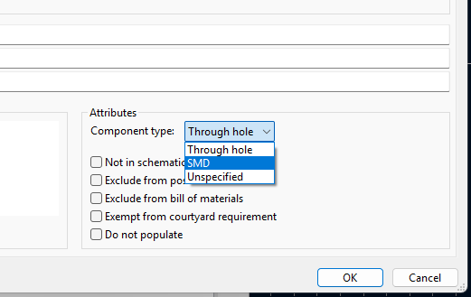

What is your footprint “Component type” ? Through hole or SMD ? the default pad type changes to match . . .
Yes. You’re right. That does the job too. Thanks for pointing this out.
