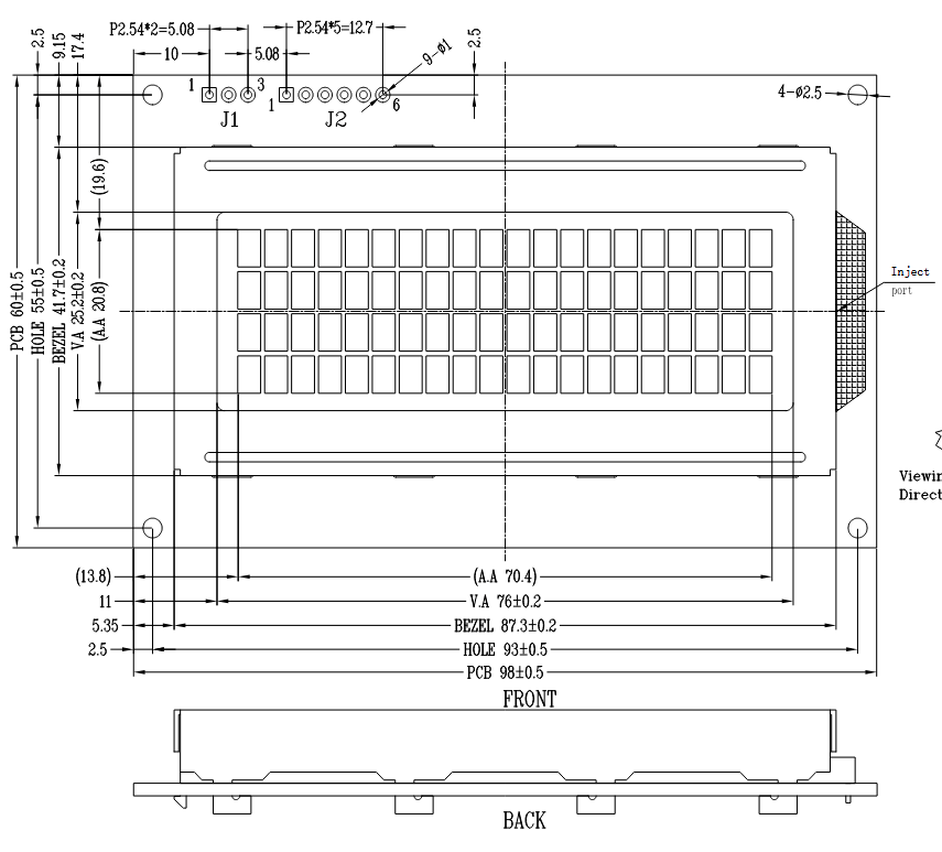

I am Eric and I have no idea how to add a LCD 20x4 Character display. It’s a NHD-0420D3Z-BBW-V3 from Newhaven Display Intl. First thing, What do you do when a Schematic symbol has 2 pins with the same number ? Second, I am trying to make an Arduino Mega 2560 shield and I would like to use 2 shields and stack them together. Should I have 2 seperate Schematics and do it that way or should I split my 1 schematic somehow and do it that way. Believe me, I have tried to look for info on the Internet but have not been able to find any info. Any help with these questions would be greatly appreciated.

I am not sure about the electrical net ? That’s why I referenced the display that I intended to use. It has 2 connectors, J1 and J2. J1 has 3 pins: 1-RX, 2-VSS and 3-VDD. J2 has 6 pins: 1-SPISS, 2- SDO, 3-SCL, 4-SDA, 5-VSS, 6-VDD. I tried to name pin 5 Cathode and and pin 6 Anode. I have the top pin 3-Passive and the bottom pin 2-Passive. I am open to using another LCD Display-20x4-I2C if it would be easier since this display supports RS-232 and SPI that I am not going to use.

OK, you have to differentiate between a couple of things here:
You have two connectors.
Each connector has several pins.
Each pin has an electrical connection to a net.
Here’s a snippet from the datasheet of your display:
The connectors you mention are top left.
If you model this display as a component, I would suggest just giving each pin a unique number, so they will become pins 1-9. When creating the PCB footprint, arrange the pins in such a way that they align with the drawing in the datasheet. How you number the pins in your own symbols and footprints, doesn’t matter; it’s entirely up to you.
In this case there is no need or advantage to assigning the same number to different pins. Just stick to the ground rule that pin numbers are unique identifiers.
